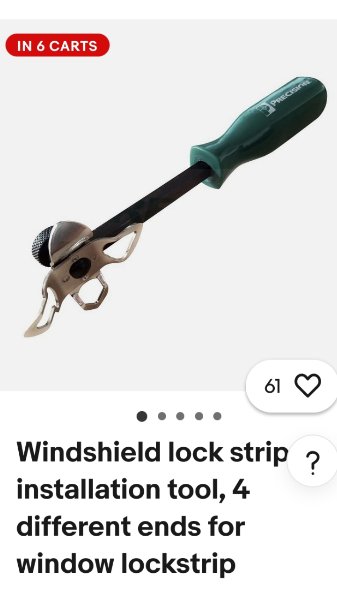

Has anyone found a good method to install those early windshield and back glass lockstrips without buying the installation tool? Is the tool easy to use? The corners are a real pain just using a screwdriver.
In my opinion, it's worth the $20 for the tool. With the time you'll save by using the tool, you can be drinking beers paid for by the money you're saving by doing the install yourself in the first place.
I agree with mopowers, it was worth the investment. It did make it much easier and I didn't have to worry about damaging the lockstrip. I'd loan you mine if you were closer.

Ebay Item Number:
332363907231
20 bucks free ship.
