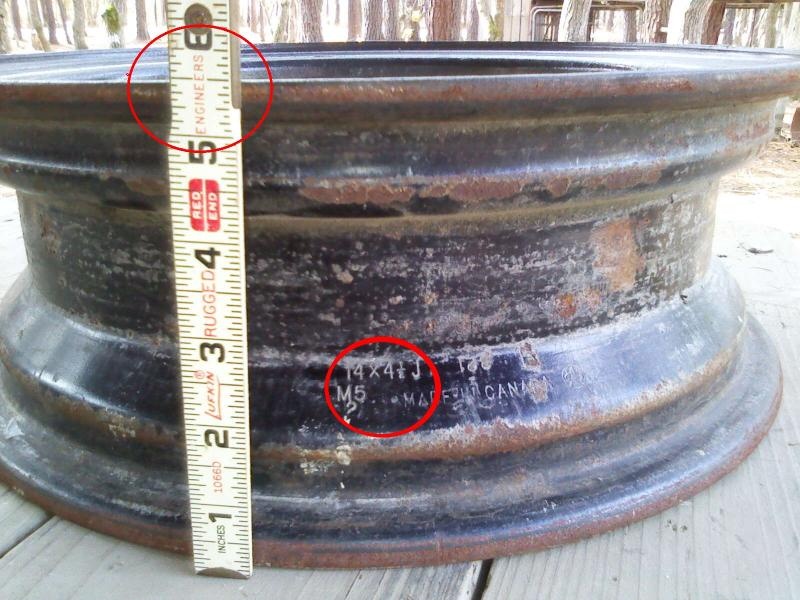

just a good reason to use a 15" wheel. i had to use a 1/4 " spacer to put 14" wheels on my charger to roll it around because it came with the big rotors. all my steel wheels fit flat on the rotor and drum faces with plenty of meat. it almost has to be the wheel design and/or the mating surfaces
every factory steel wheel i have seen has been stamped with a J or JJ along with OEM replacement wheels

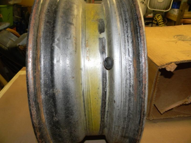

OK, that takes out the taper of the wheel since they are 15" wheels and that ship has sunk. After close examination of the wheel in the picture, you can see the front side is belled compared to the OEM wheel which is flat then a quick taper. The wheels are hitting on the back side of the wheel face, otherwise the wheel still wouldn't go on with the caliper and the spacer off. These are hitting some place and this looks like it.

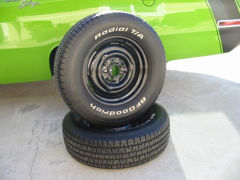

The car came with Kelsey hayes front disc brakes. It now has those same rotors and SSBC replacement bolt on calipers.
I'm beginning to think that these wheels are the problem. Can any one here running a factory wheel spin off one of your lugnuts and maybe try to measure how much stud is sticking out? I'm gonna do the same with these wheels so we got something to compare
Again thanks for your input....Pete

No, I have tried to find one. Let me see of I can explain. Look at the area from where the small hub cap would cover the lug nuts. There are humps that the hub cap snaps over. Next look at the rim where the tire is mounted. The area on your wheel looks tapered compared to the wheels where that area is flat that I posted above.
If that front wheel will go on without the spacer and caliper the wheel has to be hitting some place. If it wasn't hitting it wouldn't go on that way either.
Pop one of the rear drums off and lay it in the back of the wheel the way it would mount regularly but now you can see from the back side with nothing in the way. This will either confirm or out rule what I am thinking.
If you do this it will show you why you have a problem.
If anything, I'm thinking it's the part of the rim that the hub cap covers that is different from the factory wheel and is causing this problem. Maybe the area that the actual lugnut goes into is taller or thicker??
The shape of the wheel that you see as tapered, vs the flat of a factory wheel, I do see that difference but it isn't hitting anything so it's not the problem.
