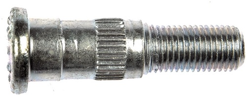

Anybody know where to get longer wheel studs for a 70 Dart? With the wheel/ tire/brake combo on this car ,I needed to run 1/4" wheel spacers. Now the studs need to be a little longer...1/2" would do it. Would consider changing to 1/2" thread also.
Any part numbers would be appreciated

(A) Knurl Diameter .568,
Thread Size 1/2-20,
(L1) Under Head Length 2.970,
(L2) Knurl Length .710,
(L3) Nose Length .465,
ARP Wheel Studs 100-7706
7/16-20 x 1-31/32"
• Knurl Diameter: .565"
• Shoulder Length: 1-1/16"
These won't be seated in the hub as deep as they are supposed to be.
