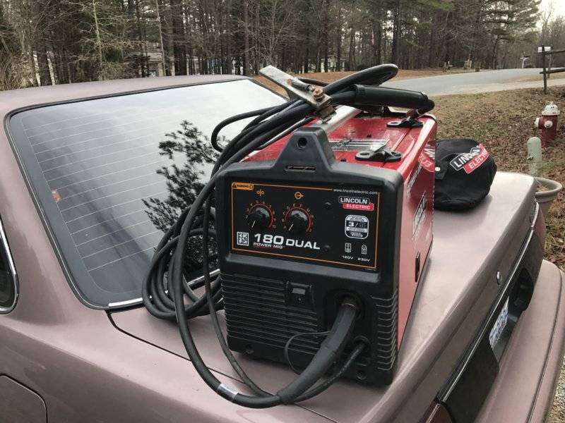

Bought mine 1 year old used off Craigslist. Looked brand new. Lincoln 180 dual. Can use 110v or 240v. This welder retailed new for over $1000. I think I paid a little over $500 for it.

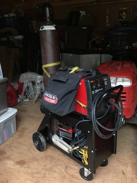

I just got my new one today. From Acme Tools. They had a 70th anniversary sale and anything over 750$ was 150$ off. It was 799$, compared to Tractor Supply at 899$. With the discount, shipped it was like 680$
Been working 6x12’s so I won’t be able to play with it for another few weeks, or maybe Sunday...
