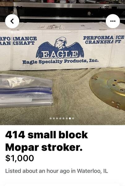

Not mine just putting this here
Seems like everything is used except for the crank ??
Wonder if the seller has run any of these parts or is this a collection of used stuff pieced together with a new crank. ??
Used Camshaft and matched up lifters to go back into the build. (think most would want to use their own cam selection).
Ok what makes it 414 ? Sorry in advance for dumb question ,thought 408 was the shillzl
On the bright side if you use his used purple camshaft and numbered lifters, you won't have to break in a new cam and worry about eating up the new questionable currently made lifters.

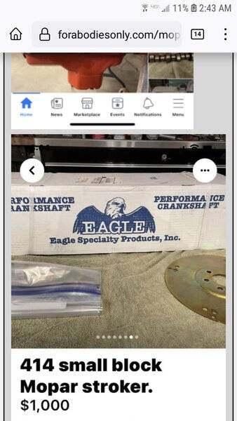

It's probably the used 4" crank in the original box. Does the ad say the crank is new?
Yeah it does. I see it. Instead of fifteen damned pages, call the guy and see. lol
Yeah it's a brand new crank still in the box, never opened yet.
Kind of looks like he has a .060 over 360 block and a new in the box 4" stroke crank.
Looks like this is the start of his new stroker build and then he stopped the project.
Think he was expecting to drop all of his other used parts on top of that base.
Unfortunately it doesn't work that way.
New Crank:

Don't see anywhere that says the pistons are 360+.060, says the block is a 360+.060
Might be stroker pistons at +.060
The pistons look like dish stroker pieces
Yes those used pistons look like dished stroker pistons like you say. Was under the impression they were running in the stock stroke 360 with the overbore of .060.
The block does not look like a fresh bore right now, like a used bore though.
So either he ran those used Keith Black pistons in his .060 stock crank 360 block.
Or it's a stock bore 360 block that has not been bored to .060 yet and he has just been collecting various parts for the stroker build as he can afford and find them. Thinking this is more the senario here the more I look into it.
He's been gathering used parts to build a 416.
