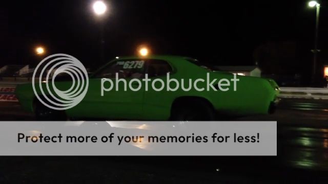

No sunshine and rainbows. Left everything set how it was with slicks, set the radials at 17.5 and spun on the first pass. Backed my shocks down from 5 to 3, launch rpm from 2500 to 2300, and pressure to 16.25. Hooked but was still .02 slow on the 60' and a 7.80. Brought the launch up to 2400, tried 16.5# hooked for a few feet then spun bad resulting in a 1.80 60' and a slow 7.92. I usually run 7.70.
The car seemed to unload on the last pass. Does that mean I need to soften or tighten the rear shocks? They're the Ranchos that came from Calvert. I have a video I'm going to try to post.
Night time,cooler air, more power, might be some of it. I would set your shock back to where they were, figure out what air pressure these tires like, then go after the shock settings.
stiffer in the rear shock extension would be next.
It's hard to see what the tire and rear suspension is doing in the dark.

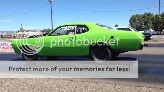

Spins at anything over 17.5. Tried bars in both holes with various preload and all the shock settings. They worked OK with the bars in the bottom hole, 1/4 turn preload and shocks at 7 with 17.25 psi. I used them at a really good track, and was 5 hundredths slow on the 60' compared to last year. I ran them on a cool day at our local track and there was no way to get them to hook. I dismounted them and went back to regular slicks.
IMO it's not the tires fault. With no more power than you're putting on them they should work on a fair track. That being said my experience with radials (not pros) is that they are hooked or not. There is no middle ground like a slick. Also every car I've seen go to radials from slicks is faster if they hook up.
What springs are you running with the cal tracs? Are the front torsion bars cranked up? How much front end travel? The car looks very stiff in all the videos.
Mono leafs, 90/10 front shocks, 4.5-5" front travel. They wouldn't consistently hook, and when they did they just weren't as quick as slicks at the 60'. When the track started to cool down in the evening, or after rain, the radials just wouldn't reliably perform. For bracket racing they just weren't working out. No one seems to understand our track conditions. It's almost as bad as no prep at all.
Caltracs are spot on where mine are. 17.5 is no where near 22. Radials need more air not less. See mickey's Web site.
I tried up to 18.5 in the 4 separate weekends I used them. It's completely irrelevant now, I went back to slicks. Radials just don't work for what I have.
Never ever close to proper air pressure. Too bad great tire.
