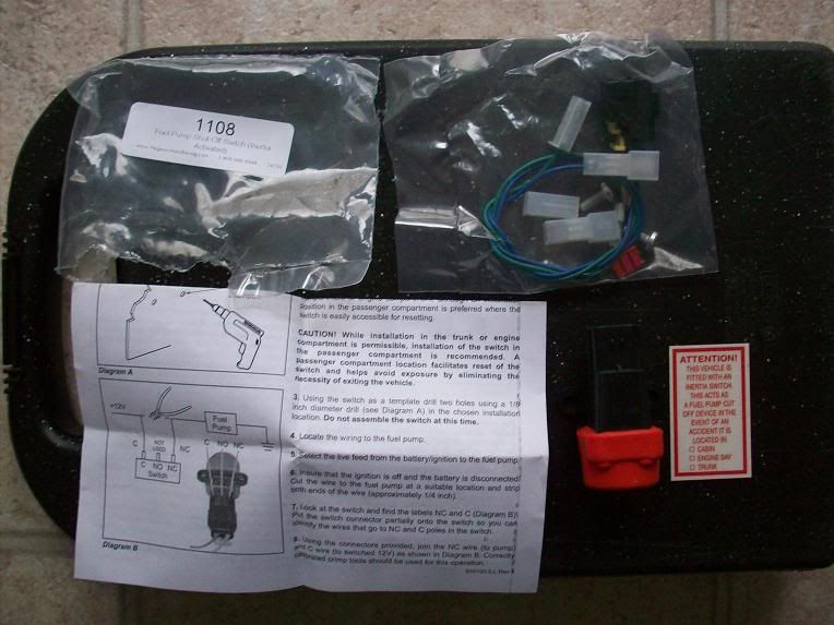

here's mine installed.
I installed one of these in the trunk in case someone plows me in the rear, it will kill the fuel pump, good idea withj electric pumps.
I got it from pegasus racing equipment.
