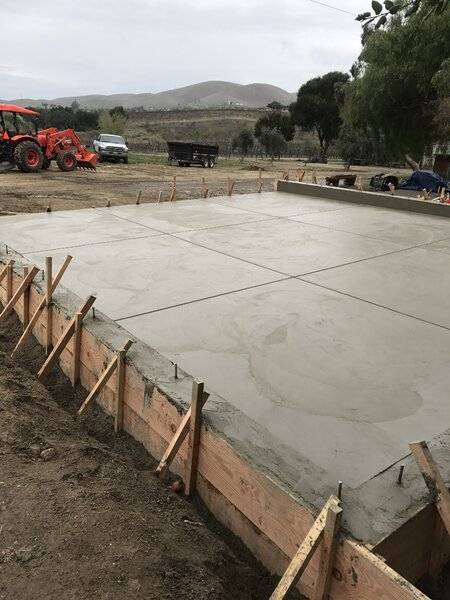

They framed my slab up all in 2 days. And did one poor on the 3rd day.

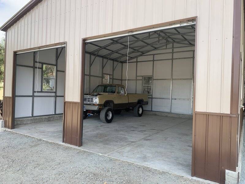

Nice HD slab with the rebar. Did not need the cuts in the slab with all the rebar. My only comment here is, You buy the building first, then you pour the slab to fit the building. I would also consider that you incorporate a rear door behind the 10X12 one. Air flow or storage may be needed at times. A pull through could also be an advantage.

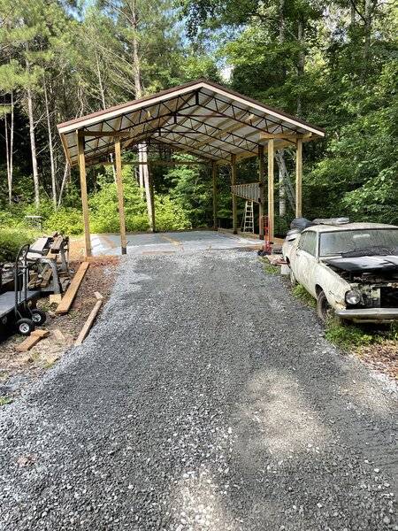

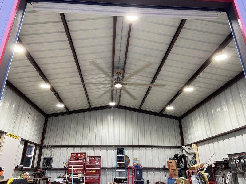

I just had my building put up.
Looks real close to what you want to do.
I use the lean to for parking my big truck out of the Texas sun.

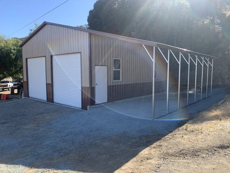

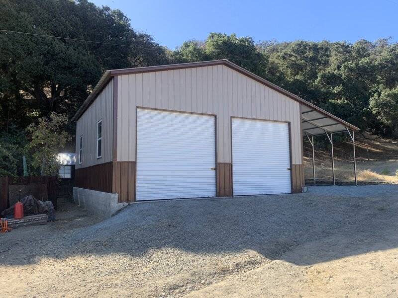

I have a 30x45x18 building. I was talked into a 22x12 single door. I hate the single door and would never recommend one. You are better off with two doors and a man door.
That's badass! If you don't mind, what was the final damage just for the building? I only ask because I see you're in California and I hope to be moving soon (within CA) and will hopefully be getting a shop built as well.

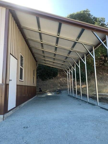

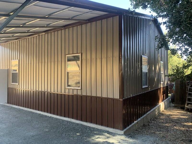

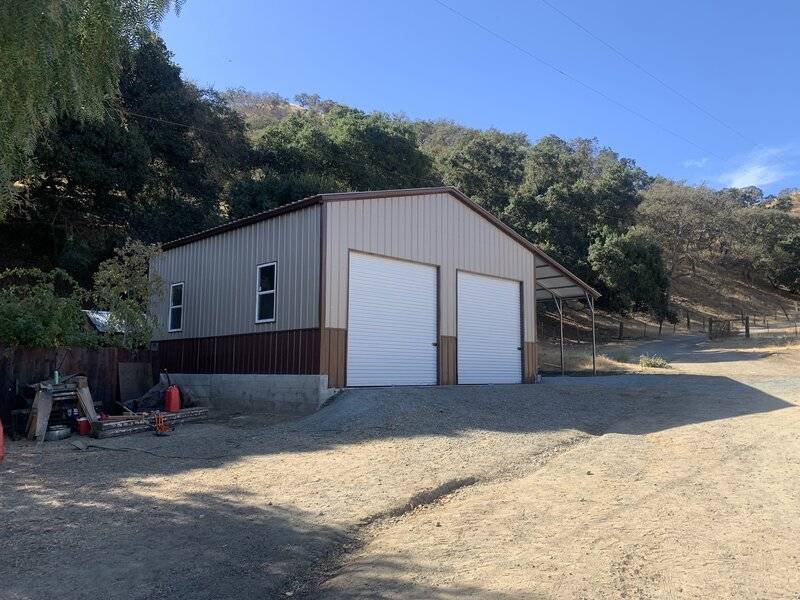

Total price for the building with lean to, was $35,125. I pretty much went with every option available.
-heavier gauge steel for the frame(12ga)
and siding (26ga)
-the larger windows 30x53
-fully insulated
-vertical side paneling which gives you 2 extra purlins all the way around for a stronger frame
-and the two-tone wainscoat I thought was definitely more attractive
I used American Steel Carports and they were less expensive by a few thousand dollars compared to everyone else.
Everything is expensive in California.

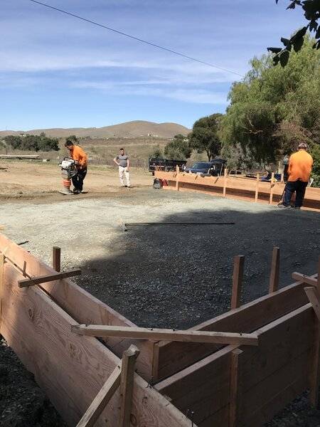

So I had that done a few years ago. At the time it was about 12,000 for everything. The loads of base rock, the rental for the compactors, all materials, rebar, forms etc etc and the concrete crew/finishers I hired. I rented a pump guy also, he was a grand. It was 38 yards, 4 trucks came out at the same time. It was stressful and it worked the guys pretty hard. They had to rush.
In todays time I’d bet it be 16-18k for that same monolithic slab.
