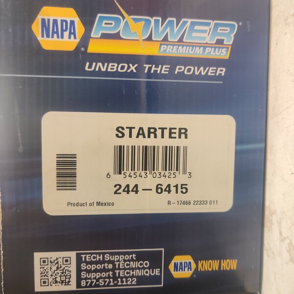

yea the new offbrand ones are cheap junk.. had one and it was giving me trouble getting the bolts in.. bought the napa (rebuilt original) one since it was local, got a discount and had a great warranty. dropped right in. bolts went in easily.
Someone told me (a while back) to pick up a mini starter for a 1991 Ram d150 318, and it worked perfect on my 225 Slant

You can also use the starter from a 2008 Dodge Ram 1500 5.7L w/ MANUAL trans. All you have to do is drill out the threads on the top mounting hole. I needed clearance for the steering box and future exhaust plans on my slant powered track roadster I built. I got it from Napa and haven't had any issues after lots of street driving And racing on the dirt track and drag strip. I will see if I can find a photo
