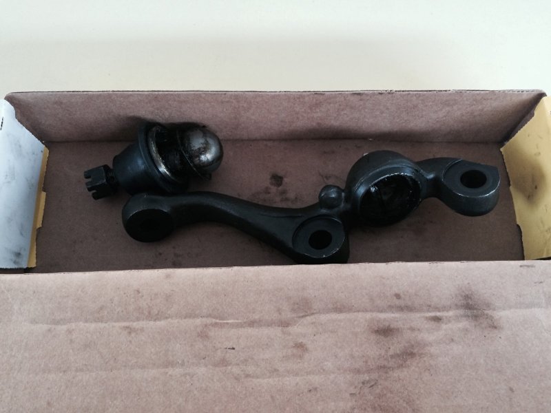

Geez, over ten years ago, my Moog lower joints fell apart before installation.
