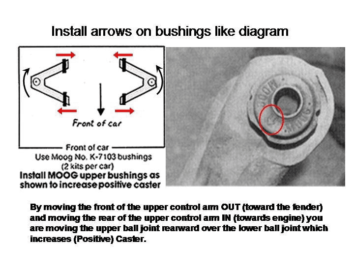

Is this correct? Uca needs to move back? Why was I thinking forward?
Correct. They used to include the exact opposite directions which were a misprint and messed a lot of people up over the years. In essence, you lengthen the control arm in the front and shorten it in the rear.
Yup. You want the front A arm bolt to move the arm OUTWARD from the center of the vehicle, and you want the rear A arm bolt to move the arm INWARD towards the center of the car
I didn't know that, and I'll bet mine are in backwards. The front end was the first thing I did during the rebuild; a long time ago. The alignment guy said he could barely get caster to 0-1* positive. Now I've got to check.

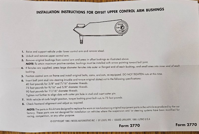

Its important to note that the picture posted above is not the original instructions to these bushings and is not included in their box. These bushings were originally released by Moog to address camber issues in fatigued cars, so the OEM instructions were set up to support an increase in camber, not caster. The last set I picked up a few weeks ago still show this.
Its only over the last 25-30 years that we have started using these to address caster adjustments which requires a different set-up, which is what the instructions posted above address. The instructions above were created by a member on Moparts in the 90s and have been distributed world wide ever since.
If you took a couple of boxes of these to a shop and asked them to install them, odds are they did it per the instructions in the box, not what is pictured above, unless you removed the original instructions and gave them this exact illustration.

They might be, but be careful. I think they FINALLY corrected it after decades. lol

That is the same picture I recall from 30 years ago.
Who puts the front of the car at the bottom of the illustration, still that way. Dumb
Also people would install and think the arrows were where the HOLES went and not the direction of actual arrows on the bushings

I've seen a lot and I mean a LOT of incorrect directions in those bushings straight from Moog.

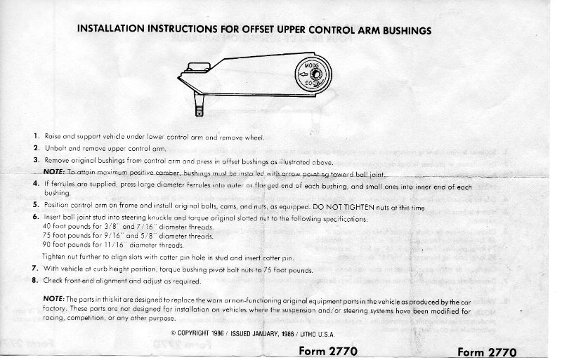

Directions from earlier package of Moog K7103.

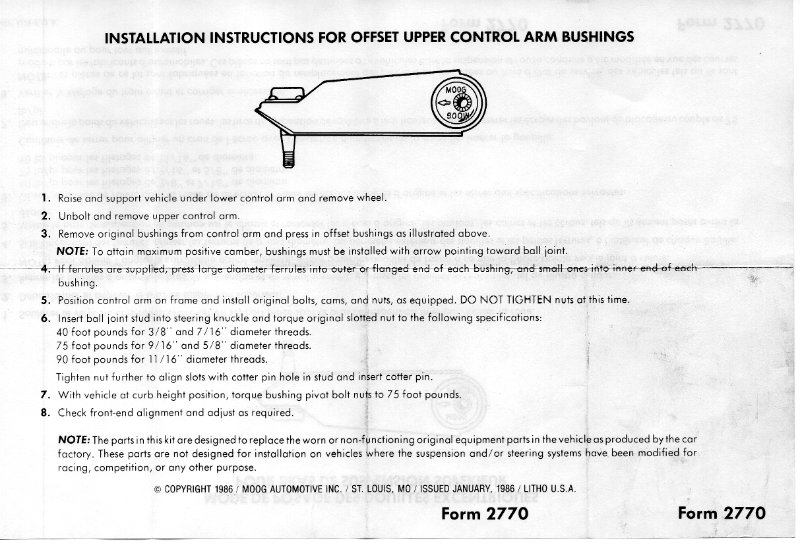

Directions from later package, around 2010.
Difference in packages:
You can look them over closely, but all that stood out to me was the removal of the reference to Moog Automotive St. Louis.
