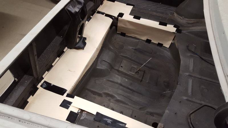

Now the challenger trunk floor ends abruptly short to that of what the duster had. So a floor extension must be created to meet the duster taillight panel. First i made a basic template from pattern paper. Then mocked it into place to give it an eyeball. From here i will transfer too, and cut the new floor pieces from sheet metal and graft them into place
