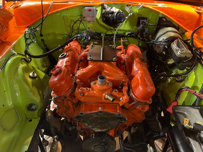

Motor Removal re Motor Mounts?

Great inputs. I did all of this already.plastic bag over tail shaft with tight rubber bands.
Only need to remove the hood and that I can’t do myself. Headers were taken out last night. That was a pita on the driver side.
I am leaning toward pulling just the motor and then if I am able install as a unit trans/engine.

I pull them with the hood on.... but I bolt a chain from the front drivers head to the passenger back 2 intake bolts keeping the slack only about 3" above the intake.
It will want to tilt as you lift it out of the car. I just get the motor mounts off the K-frame, then I slide the engine/tranny ahead. That's when I use one of those small 24.99 floor jacks on wheels to help the tail shaft over the crossmember. Don't need a lot of pressure or anything, just get it to clear.

I am 90% sure I’m going to the pool just the motor at this point. Are there four facing bolts into rearward facing bolts on the transmission housing?
