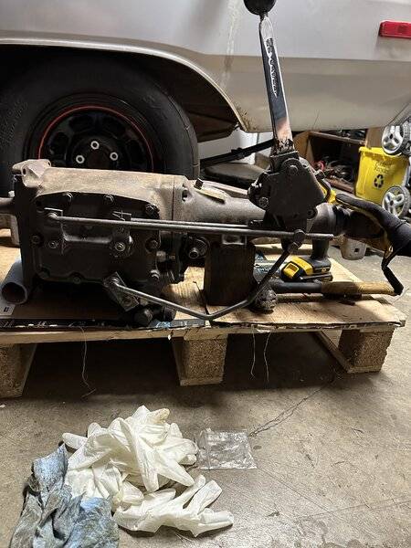

Do you have any idea which Mr Gasket shifter this is RB? The shifts are nice and short, but I can’t find any info on it.
