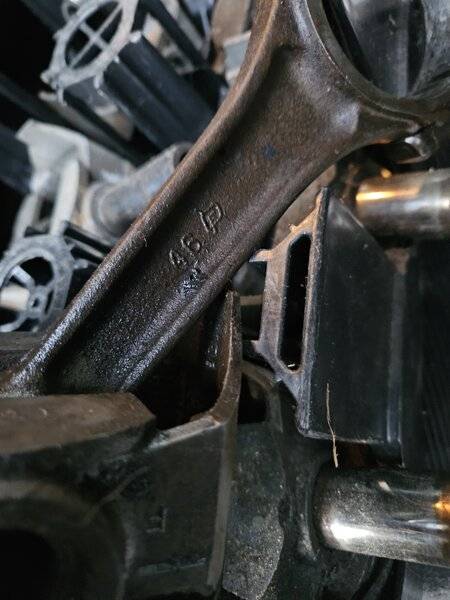

these are the rods both free floating
I'm building mine with + .020 NOS cast 72 pistons and 2.02 "J" heads, same casting numbers as yours.
Timing cover is wrong, see post #8. I'm building a 69/70 340 myself. Rods should be bronze bushed on the small end forging # 2899496 or 3418645. Only 360's and cast crank 340's are externally balanced. 273's, 318's and forged crank 340's are all internally balanced. No need to spend a lot on a 340, they came with all the good stuff. What are the casting # are on the heads? Any 340 forged crank should be good, just go to the next size bearings till it cleans up, if needed. Magneflux the crank, heads, and block before putting any money into them.

I would take the rods and crank to a reputable machine shop ask them to magnaflux and check for straightness. The heads are O's and sure look like 202's to me. I would always put new valve springs on unless I know for a fact that they are new and up to the spec. At that time you can check the valve guides to make sure you don't have any slop in them . It's going to be a process so don't get in any Rush ask a lot of questions and read some good books. Building a small block Mopar is a good one it's older but still has a lot of good info in it. Especially for a hot stock rebuild.
my mechinist is good dropping the block and heads off tomorrow ...have at least 2 years before i'm ready for the swap so just gathering parts (and info)still
