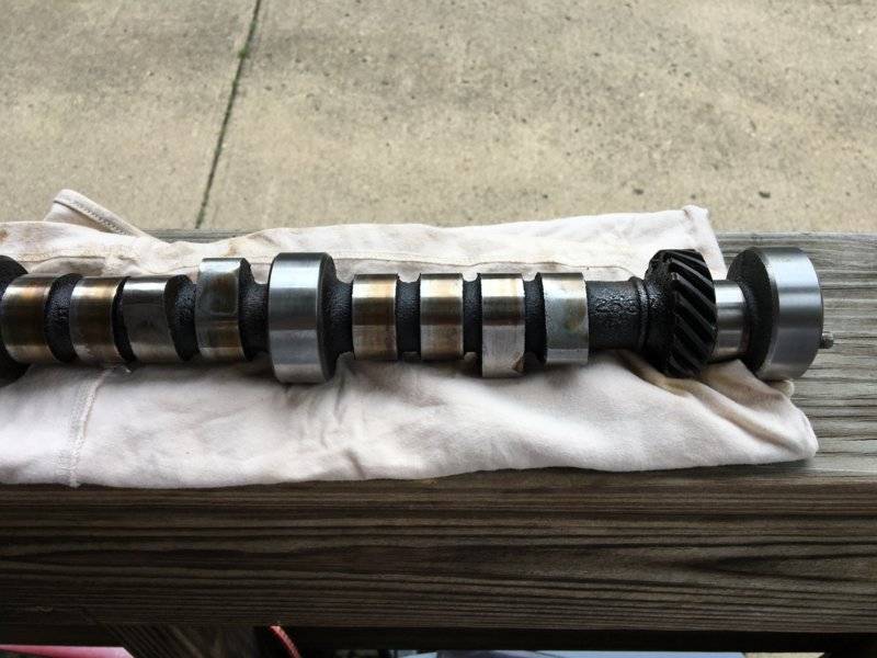

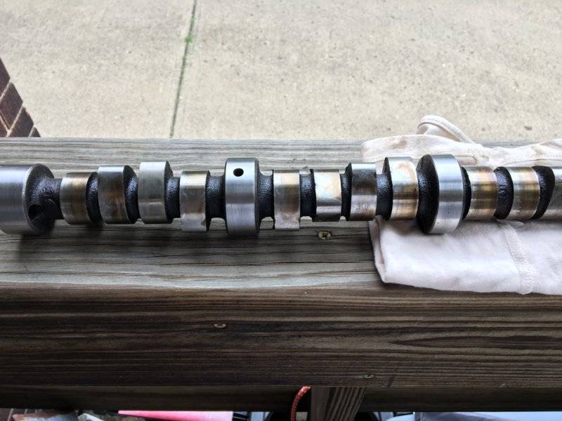

Here are a couple pics of the original 383 2bbl cam that was in the engine. Any info to learn from these pics?

To re-use your old cam, you would need to put each lifter back on it's original lobe. This where I would upgrade the cam with new lifters. Reuse rockers, shafts and pushrods if decent. Usually we replace all the valves and springs. On a budget- you can reuse the old valves if there is enough meat on them for grinding. Reusing old springs is a little chancy. Resurface the heads along with v/job.
I would recommend replacing all bearings in the motor. I have seen many that replace the bottom end bearings and end up with low oil pressure because they didn't replace the cam bearings.

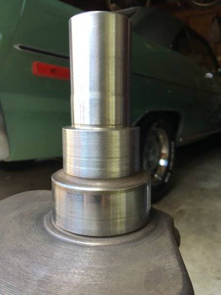

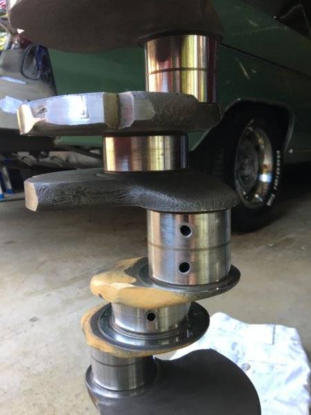

After a little cleaning, here are some shots of the crankshaft...

After a few quick measurements (more to come) I hope to polish the journals and she's ready to rock N Roll.

If the rest of the cam lobes look like those pictured, the cam is worn but good. That's a good sign and probably means the engine was in decent shape.

The main journals seem in spec, how bout the rod journals?

I've taken what seems like 102 different measurements. I get some consistency, but not enough - It's VERY hard to trust my measurements fellas! Especially using a Harbor Freight digital caliper micrometer. Even with the Starrett tools they brought, I trust their measurements much more than mine, and they took many. I thanked both of them profusely!
Here's what we (they) came up with on my crankshaft:
Main Journals
#1 2.6250
#2 2.6250
#3 2.6255
#4 2.6245
#5 2.6250
Rod Journals
#1 2.3745 and 2.3740
#2 2.3745 and 2.3750
#3 2.3745 and 2.3745
#4 2.3745 and 2.3745
Kurt was impressed with the tolerances.
