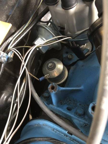

2. An oil pressure sending unit may require an adapter to clear the intake, applications vary, but the only place to mount it is on the top of the engine block, at the rear, beside the distributor. Sorry, I don't have any photos on my phone.

Don't give in to temptation to twist the oil pressure sender in by grabbing the top of it with Channel Lock pliers. I had a friend who did that on a Challenger once and he had to go buy another one because of it. Use an open end wrench on the hex. You will be better off taking the distributor out to do the work. I have that same sender on the 360 in my 71 Challenger that has an LD340 on it, and it clears just fine.
Your engine appears to have an aftermarket oil pressure line in the place the sender is supposed to go, down by the distributer base..
Do you have an aftermarket oil gauge, is so, the tube to that gauge is now in the place that electrical sender is supposed to go.
A "T" fitting can be screwed into the block, and both tube and sender can be used.
Good luck.

Yes, Got a good look down there today. Copper tube coming out going to an aftermarket gauge....How did I miss that?!? Always thought it was a tach that was added. Not sure what I'm going to do. Not experienced enough to remove distributor with any confidence yet. I will put the dash bezel in next week and fire it up finally with key. Been working on rewiring dash harness and I want to make sure everything works before I tackle this. Don't think I'll need a mechanical oil pressure gauge but I will wait and see. It's been 5 years since this car started with a key. Thank you all for the help, you think you know a lot and then you brain lock on something like this.
That tube is going somewhere, if it's not hooked up to a gauge, better make sure it is properly capped, or they'll be oil everywhere.
The distributor doesn't have to come out, you should be able to get a fitting to have the sender or tube come out the side of a brass fitting "T", with the other commingr out of the top.
