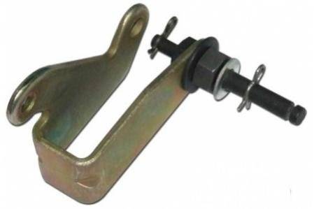

AHH! this driving me nuts i got the one bracket but i'm still all messed up please look at the pics and tell me what i need or how i can get this to work. the bracket i got is included. this should be simple just frustrated. what am i missing , got the bracket and the link i got shows same cable end just bracket way different.
so in your picture of the blue manifold, the throttle is connected where the kickdown should be and the throttle goes on the opposite side of that same stud (little side with a hole for a pin to hold the throttle). Look at picture in post #26. right now (1st picture in post #42) since the kickdown and the throttle are on opposite sides of the shaft through the carb you are pulling the kickdown forward when you want to push it back toward the firewall.
Yup, as str12-340 said, your forward kickdown rod is mounted in the wrong place. It needs to go on the same post as the throttle cable. You look to have a conglomeration of various parts from other years. The '66 and older setup is totally different than the '67-up setup. Trying to mix and match can be a frustrating waste of time. You start adding aftermarket parts to the equation, and you're in for some "fun". I recommend you get a complete setup for one particular year and see if that will work for you. The later cable bracket you show in some of your photos looks like it would interfere with the early kickdown linkage. Try using the early cable bracket and correct carb attachment post. I don't see the correct carb post for the cable and kickdown in any of your photos. They came on all the '64-6 Abody V8's (and many other early Mopars)
ok great info.. so where do i find the correct setup? thats the issue, i can't seen to locate the right parts so i'm buying stuff i think works and back to square one, just need someone or some company that sells the setup and i'm good.. i think lol
ok got # 26 looking for a part#, no link, sorry for being pain just trying to get it right
This is the correct factory AFB carb post for the kickdown and throttle cable connection. It probably won't mount exactly in the same spot as your aftermarket carb (maybe they made a conversion kit that did), but, you should be able to get it close and modify the rod length to compensate.
