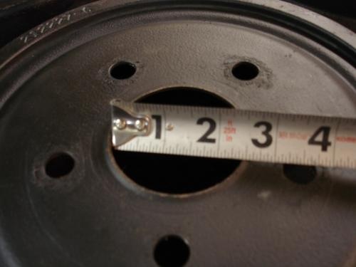

I would like to see a picture of your axles without the brake drums.

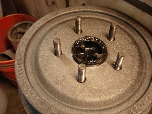

another thing I could do if I had to would be send this old drum back to Moser and have them make a new drum to match it. It says they can make any drum on their website. would be cheaper . I will get a pic of the axle this morning without the drums.
OK, here are some pics. axle without drum on, center of correct drum (21227-C ) and pics of correct drum on axle. I may not have the tape measure centered on the drum in the pic because I did not have any coffee in me yet but it is close. Does this tell you anything.
It answers the question someone asked about the possibility of it being re-drilled, clearly it hasn't.

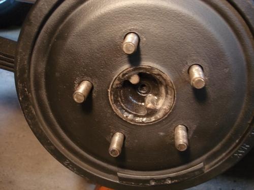

woo hoo, we don't have to go anywhere. It fits perfect. I would never have believed that a For*, excuse me, an aftermarket drum was on my Duster. Thanks Bill for your memory. You bet I am going to start a sheet with this part # being on the top of the list for future references. here are some pics. I even managed to get the new compressor in place and wired up this morning. Now to start running the black pipe. So far its been a good day. Thanks Bill.
That aftermarket drum does look like a good fit. I am glad I did remember and you are very welcome.
