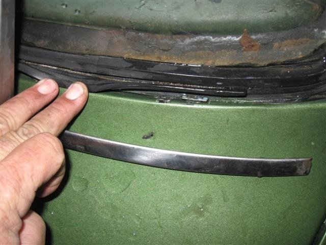

The lower stainless trim on my windshield for a 72 Dart, having trouble getting it on. It was off when I brought the car home. I'm assuming new gasket was installed. My question is on the lower edge only of the rubber gasket it has a rubber lip. Seems like maybe in needs to be trimmed off. I can't seem to get the stainless trim over or even under this rubber lip and get it to clip in. Anybody else dealt with doing this and had any problems?

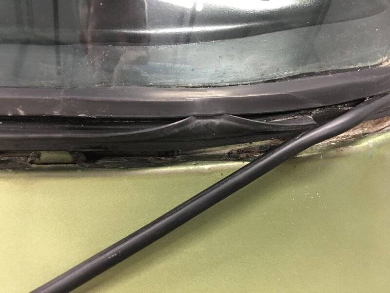

It does have a separate lockstrip, but it is just a round black rubber cord. When installed you just see the top of it as in your pic.
My new seal stood up exactly as you picture it. Use a trim tool or dull screwdriver to push down the flap and guide it under the edge. I know it looks like it won't go or stay...

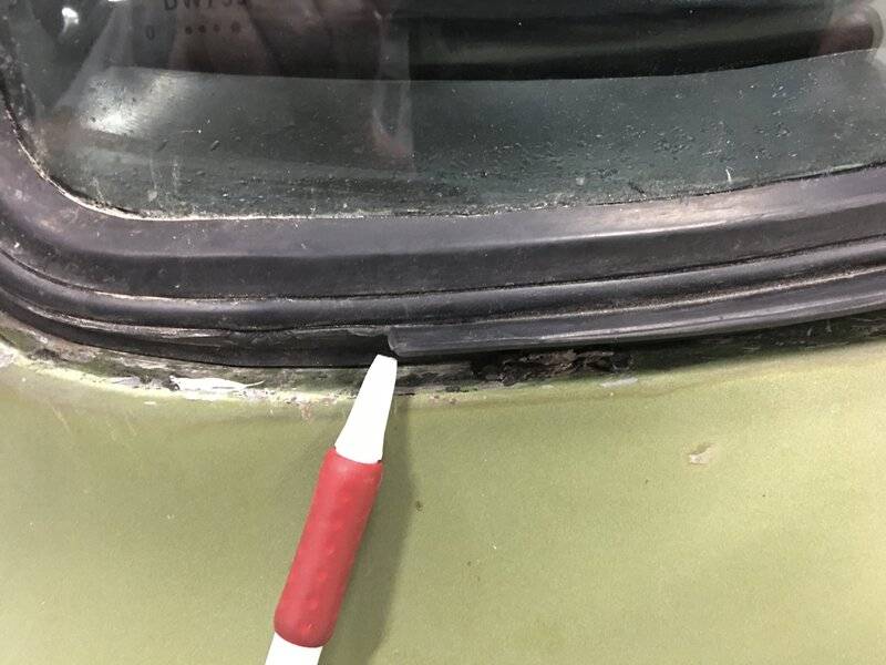

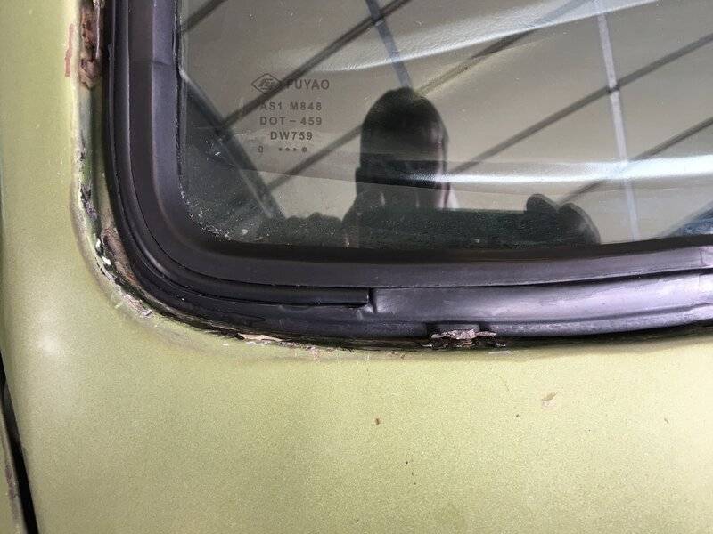

Hi Jeff, Got your PM... Do not cut the flap! The flap closes the bottom by itself. The lock strip does not go all the way around.
Out of curiosity, what is the purpose of the flap? So the lockstrip is cut where the flap starts and then lockstrip starts again where the flap ends?
Not sure why they made it that way. But, the bottom also just sits on the metal. The rest of it goes around the metal... I think maybe the lock strip helps it grab the flange tighter? Or maybe putting the strip in the bottom distorted the seal more than they wanted for it to lay right under the trim? Just my guess...
That’s the pic I was looking for! Thank you sir for your quick response. Sure doesn’t seem like that’s how it should go, but no way to get trim on with the flap exposed. I’ll get after it later, just waking up in this neck of the woods!

Yes, tuck it all the way around.
The flap is what expands the seal to snug it to the frame. The older lock strip is doing the same as the flap. That's why they start leaking once the old chrome lock strip dries up, cracks and falls out...the reinforcement is gone and the seal is allowed to shrink over time with hot/cold temps and leak city
