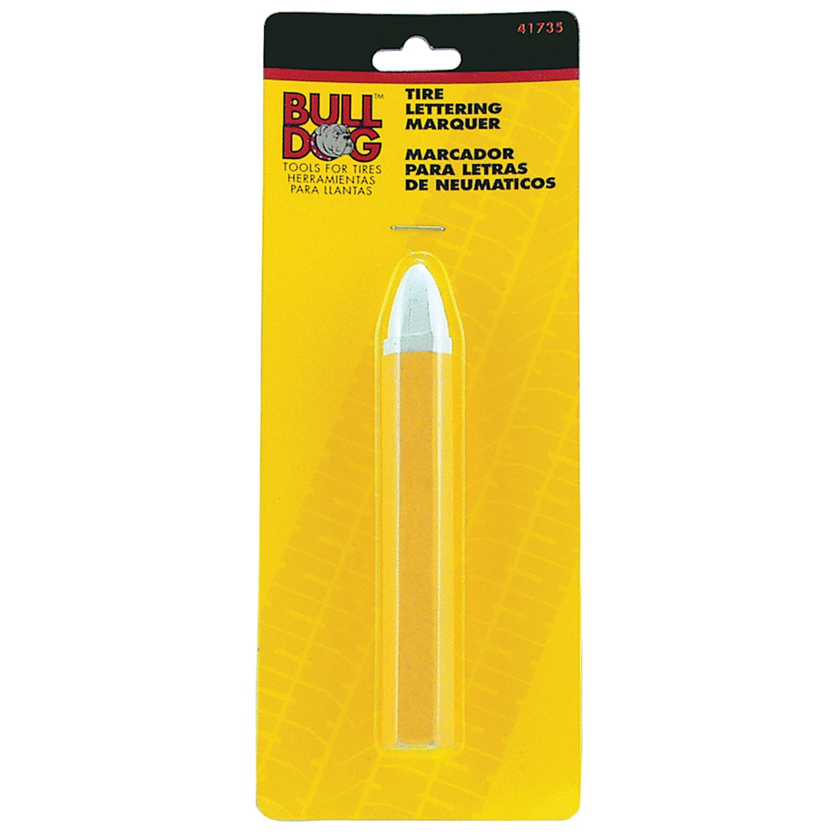

When I had raised letters on mine I also used the Wesley's and then I had a white letter stick I used as well, I am now lazy and I don't want to mess with that so the raised letters are now on the inside and I used black tire paint on the letters cause seeing letters on the inside doesn't look good to me.
[ame="http://www.amazon.com/Bulldog-White-Tire-Marker/dp/B004FEJLBG?tag=5336108632-20"]Bulldog White Tire Marker - Amazon.com[/ame]
