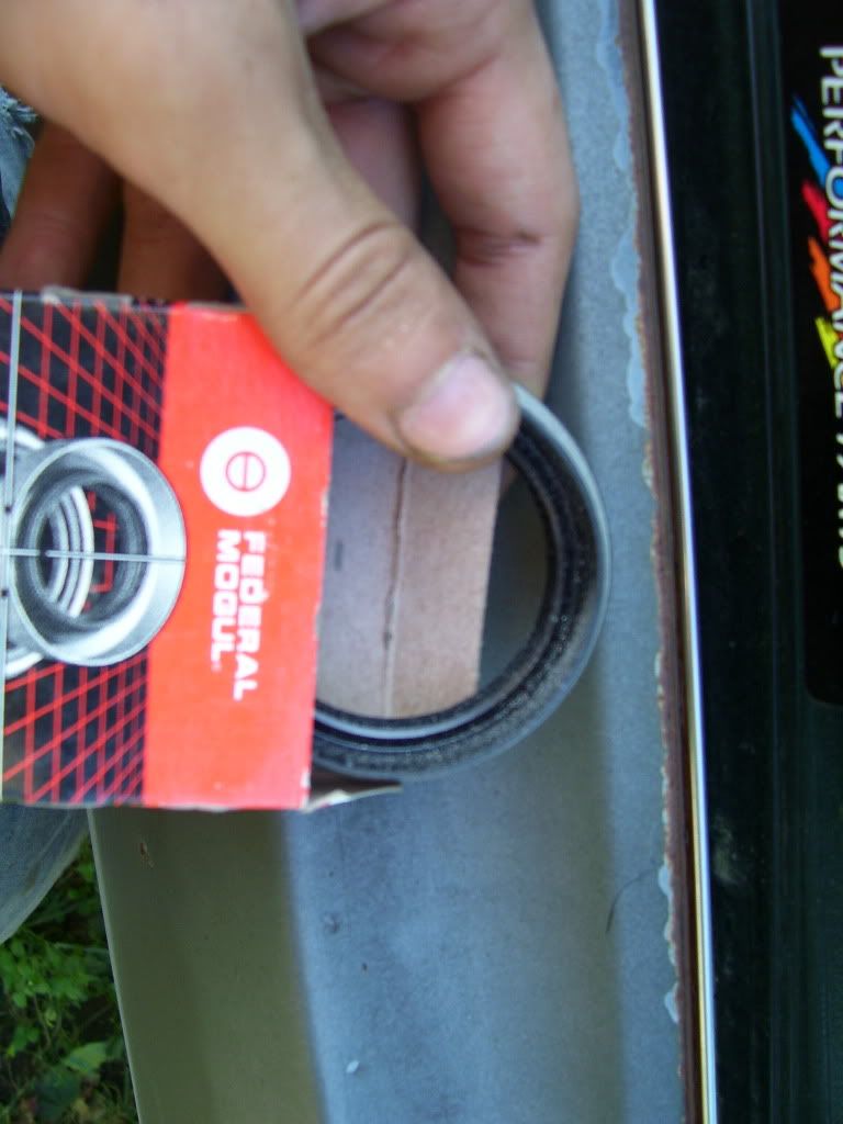

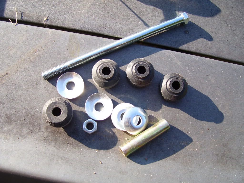

a long time ago my father bought new bushings and brakes and torsion bars and everything to rebuild the front end on my car. he did one side when he got the parts a long long long time ago. then the car sat for a few years. then i became mechanicly inclined and decided id tackle the project. i blasted and painted everything. now im attempting to reasemble it but i would like to know where these parts go before i go any further.(im trying to figure out where everything goes before i put everything on)
http://img.photobucket.com/albums/v221/sirdan/100_2468.jpg
http://img.photobucket.com/albums/v221/sirdan/100_2467.jpg
http://img.photobucket.com/albums/v221/sirdan/100_2464.jpg

the first picture is your sway bar end link. The second pic is not clear, so I'm not going to guess. The third pic is seal, perhaps the inner bearing seal on the spindle. The part you're looking for the name of is called a strut rod. As far as tightening everything when it's on the ground I like to tighten everything as I assemble it, that way if I get distracted I'll know it's tight and won't be coming loose or run the risk of coming loose once I drive it. I do double check my work, just to be sure. Remember for sanities sake and less stress, though, the torsion bar should be adjusted with the car off the ground, otherwise you're jacking the car with a wrench, making it that much harder.
sway bar end links like already stated.
strut rod bushing..
some kind of seal. maybe the inner bearing on the drum/rotors ??
http://img.photobucket.com/albums/v2...n/100_2464.jpg
Second pic looks like the old style strut rod bushing. You might want to consider the new upgraded version if available.

where does the strut rod bushing go on the strut rod? and thanks for the help :cheers:
**edit** what does it go on the end that goes threw front of the k frame instead of those biscut style rubber bushings? do i use the sleeve still? thanks alot.
