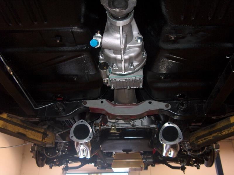

Any bottom view pics?What kind of header and starter room do you have?The torsion bars are gone with this set up right?

tons of room for headers and starter.

I have a few shots from under the car just out of town right now. Yes torsion bars are gone and tons of room for headers and starter.
Few lil things i learned.
We dropped the engine and headers in first before the trans. you will have to at least loosen the header to get a 727 past them.
We had to hammer the header tubes a lil bit to get the steering shaft clearance we needed. I will post more pics when I get back.

Those headers look really low, how much ground clearance do you have on them? Any pic's?

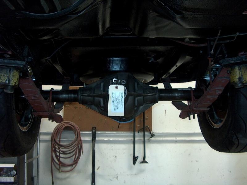

is that a Gregs Rear End?......if it is , better have it checked BEFORE you button everything up
I put one of his (truck Danas) rears in a friends car.....the gears and posi unit were total junk...less than 500 miles on em' and both needed replaced. I would warn anyone considering doing business with him ....STAY FAR AWAY
