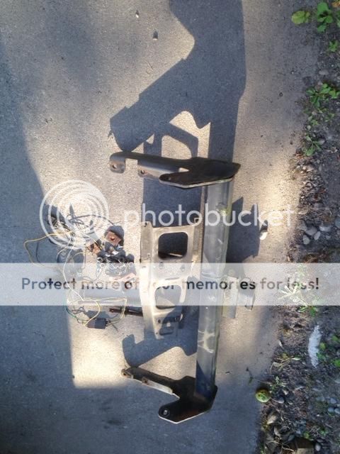

while waiting for parts to get here i couldnt resist the urge to crawl under it and yank the trailer hitch. this thing is never gonna be hauling anything but ***. while under there i pulled the heavy *** bracket that the old spare tire mounted to. has a little cable wench deal too. dropped over 65lbs off the *** end.
