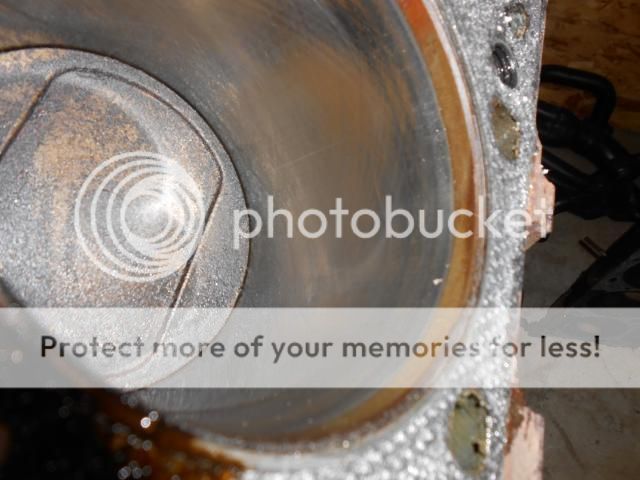

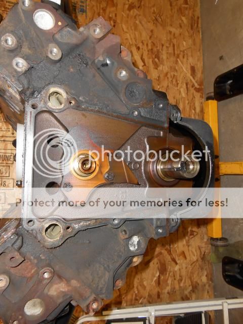

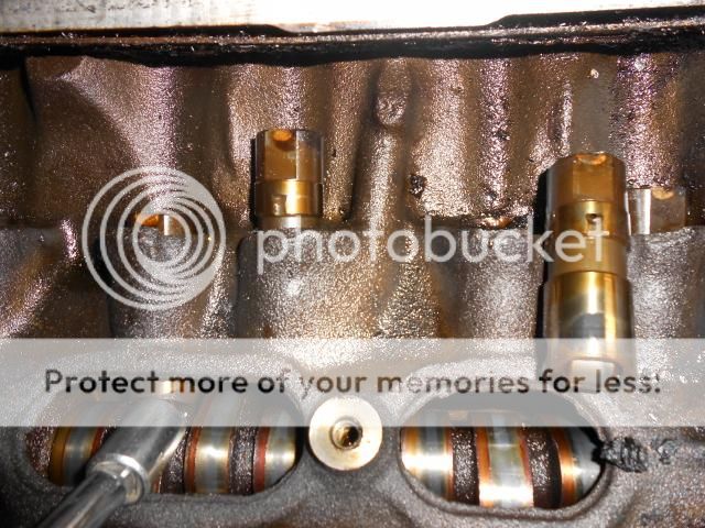

well i tore into the mag motor last night. was happy to see cross hatching in all cylinders. the pics dont do it any justice but all 8 cylinders had cross hatching still. so we are moving onward with the build. i took alot of pics more for my reference but who knows they may help someone else. here are the dis-assembly pics.
Looks pretty clean in there
It's got a bit of crap but that's to be expected. Lil worried bout bottom end. Cam bearings are pretty worn. Gonna have new bearings pushed in and run it though. If it throws a rod at 6k so be it. Just go get another one. Lol
Mine was crustier, should be fine. That intake & cam,should wake it up. If you jump to E.Q. heads ,work the plenum/ drop that divider intake plane down.(J.M.O.)

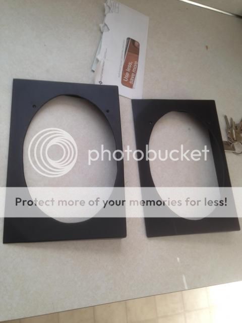

well got started with the stereo install this weekend. you know me..... cant do anything the easy or stock way. truck had provisions for wussy 4x6 rear speakers. thats just not gonna cut it. so i made custom mounts for a set of 6x9's. got em built and mocked up this weekend. they are off at powder coat now. gonna be a semi gloss textured black. they should blend in nicely.
got the speaker mounts back from powder coat and they look pretty good.

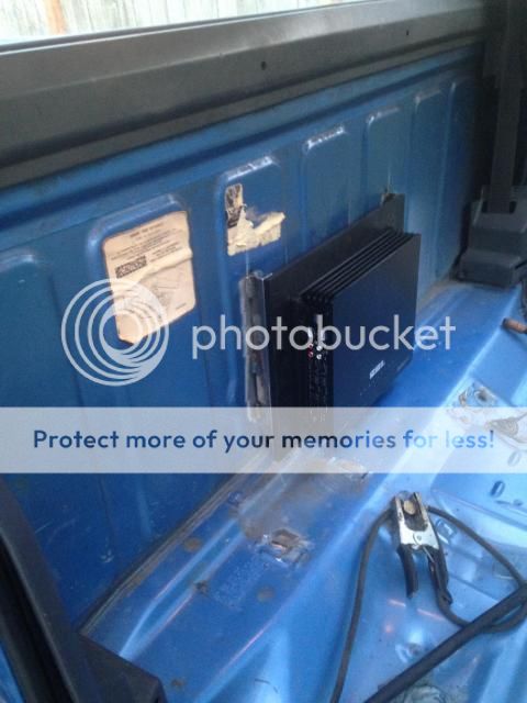

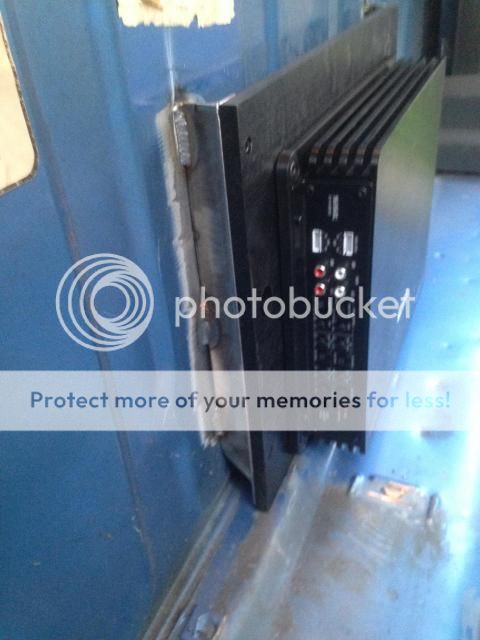

then i got to working on getting the amp mounted. got the brackets made up and welded to the back of the cab. gonna do a mock up install then go back and tape it off and paint. thinking i may make a trim board and clue some carpet to it for the entire back wall behind the cab. kinda clean it up a bit.
