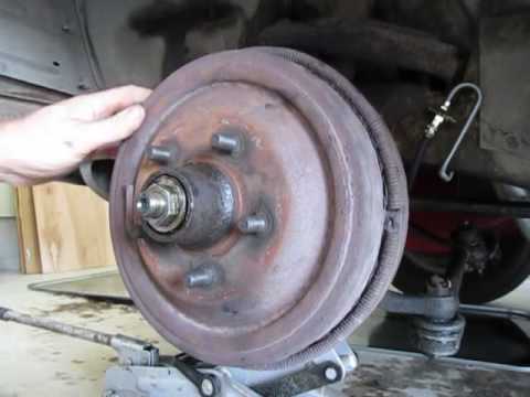

I've seen a bunch of original drums that have a spring wrapped around the outside of the drum. I've always guessed that the spring was to stop some vibration or resonating noise.
Its called the anti howl spring.....?
