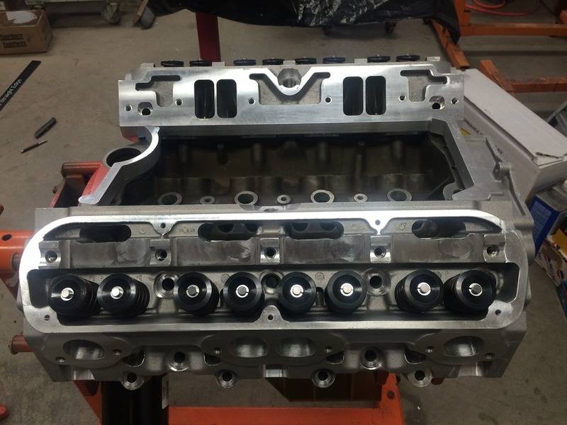

Nice!!! lets see the intake side.

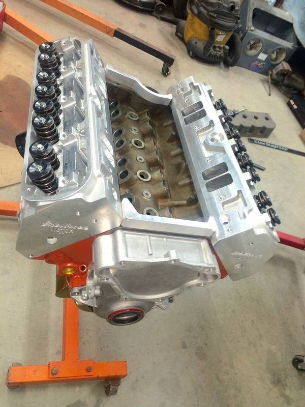

This is a 48 degree block so there's some clearancing for pushrods but it's nowhere near as bad as I envisioned and IMO fits better than a 59 degree setup would. I also have to machine for the inner row head bolts. For some reason, Edelbrock put a tapped hole with a helicoil there as if it were like a hemi and used inner valley studs.

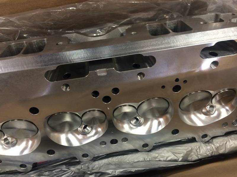

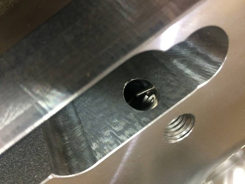

In fact, you get a set in each box! Lol. Here's a close up of the inner head holes.
Each inner head bolt hole is intersected by an oil drain passage which is just flat strange. Here's the top side of the oil drain
Further examination reveals the fact that these threaded holes don't even line up with the inner head bolt locations so there must be some other reason why they're there.

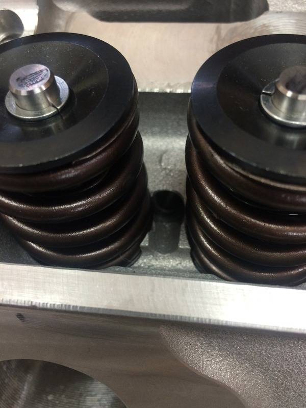

For the roof, the only reasonable hinderence is the one head bolt that is set lower than the others, those you press a .080 hardened washer into. I find one set out of probably 4-5 sets , that have the potential to go the big numbers, not every head will.
