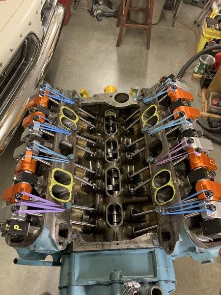

I came up with this today while installing my rockers . Its always a pain keeping the pushrods positioned while torqueing down the shafts.
Another method is a length of welding wire or similar laying across the head in front of the pedestals, keeping the p rods in place.
Ive done that as well but This way keeps the pushrod seated in the lifter bucket .
I like it and thanks I may try that today as I will have my rockers on and off a couple of times checking my valve spring clearance mods. I’ve also used the dipstick trick but all that does is keeps the pushrods out from under the rockers.

LOLOL I just think YOU WANTED TO SHOW OFF THOSE PORTS!!!
Yeah I used an interior decorators trick and outlined the ports in yellow so as to draw your attention to the area...lol
Or I used it for contrast to check the port match with borescope ....
OK- a dumb question. What is the purpose of such large exhaust cross-over in those heads? Intake/exhaust look amazing!
Those are W2 heads .. no crossover just a big deadend hole .
