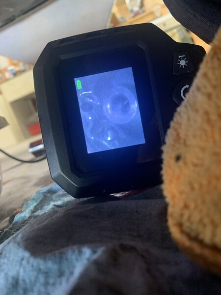

No that did not solve the problem. I now have a small amount of flow at the gauge but only about 2-3 psi. The drill did have a little more drag on it than before, but not like I have experienced in previous engine rebuild start ups. I checked for the plug in the lifter area by the distributor. That plug is there. (See picture). Is there another place that should have a plug that was left out?
Did you check for the drive in welsh type plug in the vertical galley under the oil sender port? I showed that earlier
