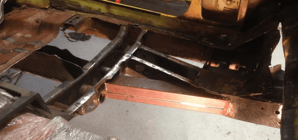

Love your car goody!! I see you are running a stock suspension and a t-56. What mods did you have to do to the torsion bar cross member? And, how do you like the tranny so far?

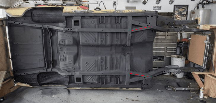

Thanks! The torsion bar crossmember took some pretty decent modifications to get that to work. The crossmember over was a quick design that I whipped up, it provides some structure to that area. I also added 2.5"x2.5" square tubing and created the forward members shown in red. They tie the forward frame rail to near the torsion bar sockets, they will take some torsion bar load as well.

Found another picture showing the forward frame members that I added. You can see how it helps connect the dots coming from the subframe connector, and it will help keep some of the torsion load directly out of the torsion bar crossmember.
