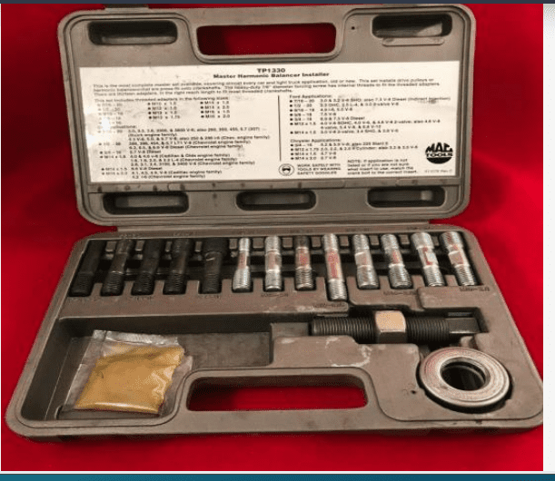

Is it just me. But I have always used a long bolt and a nut and a couple of washers with lube between the two washers. Screw the bolt into the crank with the nut and washers on and tighten the nut, same as a PS pump pulley.
Poor man's installer. Nothing wrong with that!

That's the ONLY way to do it
PAW balancer says to put it into boiling water to install it. 200F, 212F...whatever works. I like the jackscrew/nut method myself. Much more civilized.....I've seen that guys vids before, I like his attitude.

You guys wouldn't expect any less from me would you? There is a proper tool you know. LOL
