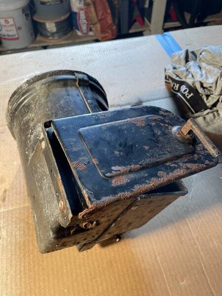

The driver's side fresh air vent door hinge is broken on my 1965 Dart. Looks like the bottom hinge rusted shut and it broke the hinge bracket off at the bottom when someone tried to force it open. The vent box itself is in pretty good shape. I could reuse the duct if I punch out the rivets and replace or repair the door. I've even got new gaskets.

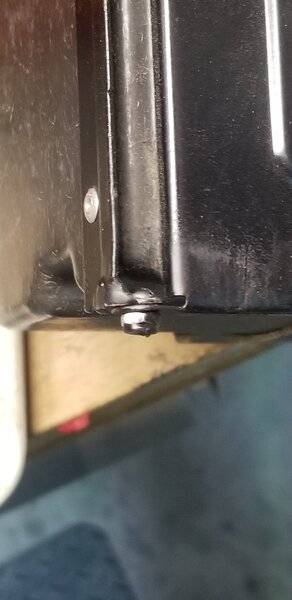

Similarly to #6, I used a hardware store hinge to fix mine. Not as elegant as #5, but it worked well. Painted black, it was virtually unnoticeable - except to me. I did eventually find a mint condition one on ebay for a ridiculously low price and put it in, with a new top weatherstrip/seal from DMT.

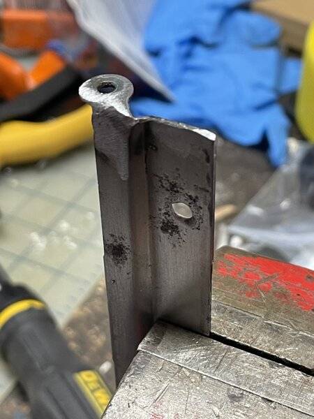

I decided to go with repairing the existing hinge. I just had a buddy weld the hinge, he did a great job and getting the rest ready for paint. It’s looking like it’s going to turn out great! I’ve already got the foam seals from a DMT firewall kit I ordered months ago.

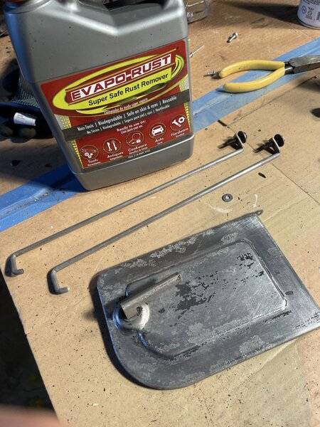

BTW. If anyone is interested, I tried out Evaporust and I’m really impressed with it. After an overnight soak it really cleaned up the rust. A little brush action and the rods and bolts look like new.

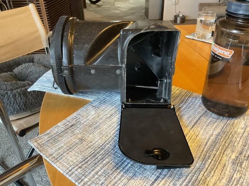

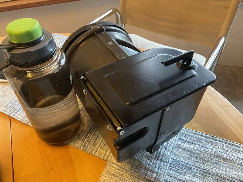

Well here’s the Before and After pics ready to install. It turned out way better than I expected. Thanks for all the input everyone!
