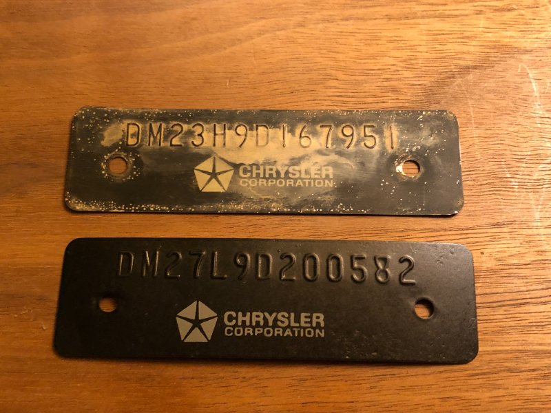

The tag (and rivets) should be satin black, ECS sells dry transfers to restore the printing on the tag.
Alan
Thanks guys! The tag itself is in good condition and the VIN numbers are clear. Cuda Al says it should be satin black I assume paint it and then the dry transfer goes over that? What does the finished product look like? Anyone have a picture? BTW, I assume the dash frame itself should be satin black since my dash is black. Is that the correct shade or should it be a duller finish? If I took it off, where to get the rosette rivets?
Okay, I found a how to video on you tube and the rivets at ECS. Thanks Cuda and Professor!
Dashes were painted with suede paint that's still obtainable (or something very similar) for around $200/qt. Rivets and transfer will be another $60. Or you can try searching here for various methods and recommended paints to finish your dash. I have used SEM trim black at a distance to achieve a close replication. You can decide what is best for you....best paint, method or cost.

If you remove it to restore it, grind the butts off the rivets on the underside of the dash instead of trying to drill them out from the top. If you try to drill them, they will spin and booger up the VIN tag. You can get a kit from ECS with the dry transfer and correct new rivets. You're not doing anything wrong or illegal by restoring original parts.
:thumbsup:
Looks good Cuda. I took mine off and painted it today. My transfer should arrive Saturday.

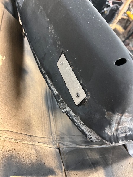

I sandblasted all my linkage and brackets, but the dash frame was somewhat rusty on the back side but too big for my cabinet. I soaked it with Evaporust for a couple of days using paper towels to hold it in place and resetting frequently. It got most of the rust but not all and it flash rusted a bit, so I went to KleanStrip to finish. Took me a few days but it ended up pretty good. After a wipe down with some cleaner, I hit it with Rustoleum. I’m now ready to turn it over and prep and paint the front side. It won’t be hard to get to like the inside, so pretty straightforward to prep and paint
