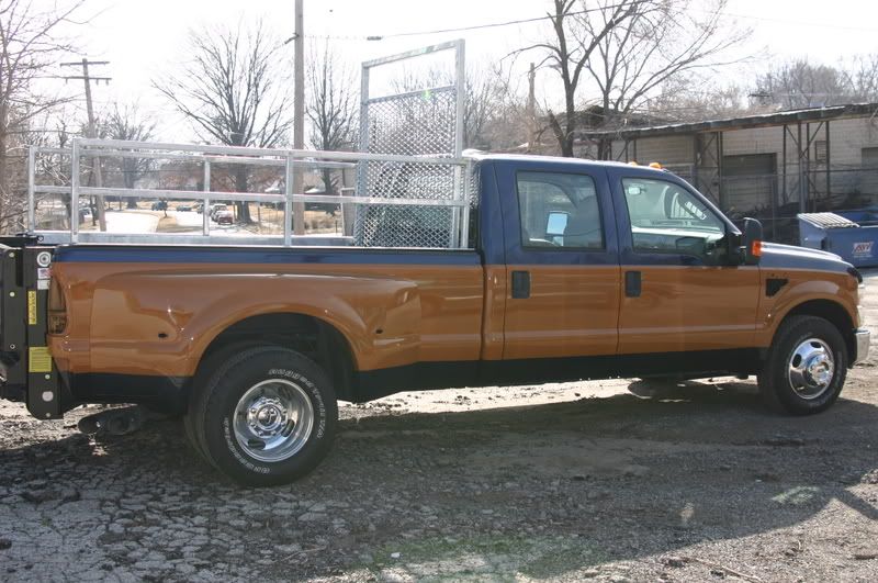

I ran in to the same thing earlier this year when painting the boss's new truck. I couldn't get it to lay flat and the gun was just not atomizing it correctly. I finally dumped what was in the gun and completely disassembled it, let the gun soak over the weekend and gave it a complete cleaning. After that it went on like glass. The trick to getting a slick job without alot of sanding is to lay it on to the point you think it is going to run on you and then pray it doesn't. Here is a shot before it was sanded and buffed.
