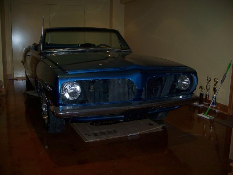

attachment.php
Who has a floor like that? you keep the car in the house?:toothy10: Great looking car, can't wait to see it done:cheers:
I don't have a lot of garage space so yes....once in a while there is a car in our house.....right now its the fat blue fish's turn. :toothy10:
