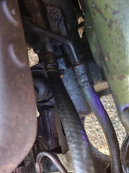

Hello all,
I have a power steering leak. The spots with the red dots are where the line is leaking from. I was hoping someone might know what I am looking at and the name of the part. I think it's the power steering fluid return line.
What's a good website people use for mopar oem? I can't seem to find this part, if I have identified it correctly, anywhere.
Thanks
Buy a new power steering hose from autozone, cheap. They have them. I bought one for my 1967 valiant there. 29.00 bucks.
The return line can be a peice of transmission hose you buy by the foot.
That's the pressure hose, I don't know if there is a website that offers oem parts like that, someone may have a nos one, but I'm not sure where to look. I typically use Rock Auto for a lot of the replacement parts I need. If there is a hydraulic hose repair shop in your area they can often make a new one for a reasonable price in my experience.
As a side note, it is most helpful to include the year, make, model, engine size etc when asking for help with something.
Good luck with your repair.

I purchased my pressure hose from Classic Industries. Just make sure that yours is either a flared fitting or an o-ring
one. Mine called for a flare fitting hose end but my OEM factory pump took an o-ring hose. I found out from very good sources that on the assembly line if your pump was not available, they grabbed what was and used that.
As far as engines were concerned, B-body parts could be used on an A-body if it fits. Just to keep the line moving. Speak with their techs to find out which hose type you need, it will save a lot of time.
Degrease everything so you can see exactly where your leak really is coming from.
The second red dot on your picture is on the transmission cooler line
Is that leaking too, or a mistake?
Good news! I didn't drive it. (beyond the lap around the block). As far as why I though it would be ok to drive empty, I have no idea. I tend to learn things the hard way. Classic Industries was a great recommendation! Got the part for $30. Waiting for it to arrive. After I install that I have an oil leak to hunt down.
The second red dot is the same power steering line. It was leaking at two spots; the crack in the rubber and at the hex nut.
you are right, i was looking at it wrong

Ok, so classic industries is going to take a very long time to send the power steering pressure line. It is out of stock. Auto zone does not have one.
This pressure line has a section on either end that is steel (photos above). Is there any reason I cannot replace this line with one that is entirely rubber tube? Can I buy these end fittings, the nut with the hole (what are these called?) and cut rubber tube to length, then crimp those things on?
Autozone sells the same high temperature tubing with the same diameter. I'd just have to cut it to length. These nut things looks like 1/2 inch.
It's not a pinion nut...
It's a high pressure line. A piece of hose with a clamp won't hold the pressure - that's why Chrysler didn't go that route. 4spdragtop is right you should be able to go to a place that makes hydraulic or AC pressure lines and have them copy what you have.
Yeah, I found a place that will make one. It's twice the price of buying one from classic industries. I wanted to double check and see if there was a do it yourself route. I'll follow the advice and get it made at the shop. Better than a line potentially failing and better than waiting a month.
Richard Ehrenberg sells the pressure hose for 68-72 V-8 A Bodies on eBay for 33.86 with free shipping. The Chrysler part number is 2891078.
