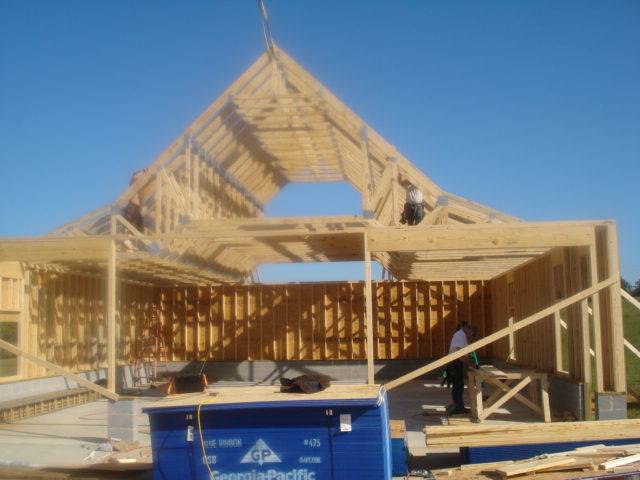

I did 10 foot walls then coffered the bay for the lift gives you 13' 6 feet ceiling height. Just have to order the correct trusses. Saves a bunch of money.
I can provide pic's if interested.
