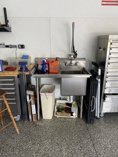

Not only plumbing, but hot water to a hose. Maybe a down the line thing but instead of a standard sink I put in a restaurant sink with a sprayer right next to my bench. I use that thing all the time.

Not only plumbing, but hot water to a hose. Maybe a down the line thing but instead of a standard sink I put in a restaurant sink with a sprayer right next to my bench. I use that thing all the time.View attachment 1715950659
