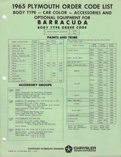

On the hamtramck site, I found Mopar codes for the stripes, AW4 is for the 1965 gold stripe (my choice). 1965 Factory Service Manual (page 23-95) shows stripe is simply the body color for that year/color. That is Ditzler/Dupont Code 22461 called Gold Poly in the FSM.

And let's say if the 65 Barracuda had the "Factory" painted on the Gold Stripe...
The paint code on fender tag would read... " WW4AA "... But many were done by Dealers back then... Just saying..
