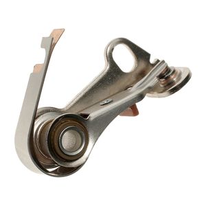

So On AutoZone these are the points listed for a '70 225 slant 6
Duralast Point Set CR1011MV​
ndd-icon.svg
Free Next Day Delivery Eligible
Duralast Point Set AL1021MV
Duralast Point Set AL1021MV​
