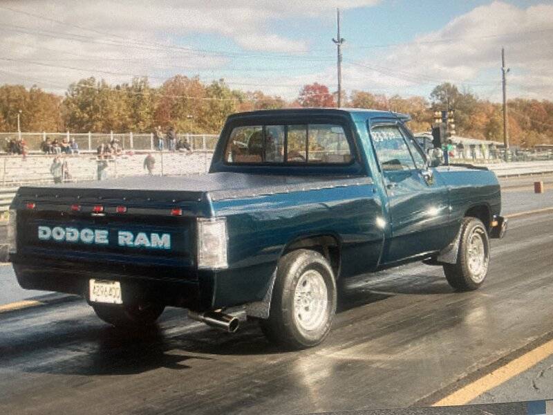

Traction bars work well on my D150 as they eliminated the wheel hop .( 15.0 E.T.s / low 2.00 60 fts ) My 68 Dart race car had S/S springs for years but I switched to Cal Tracs and my 60 ft consistency improved .
