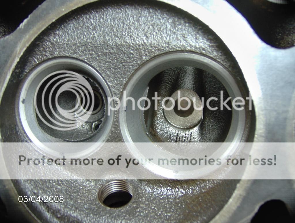

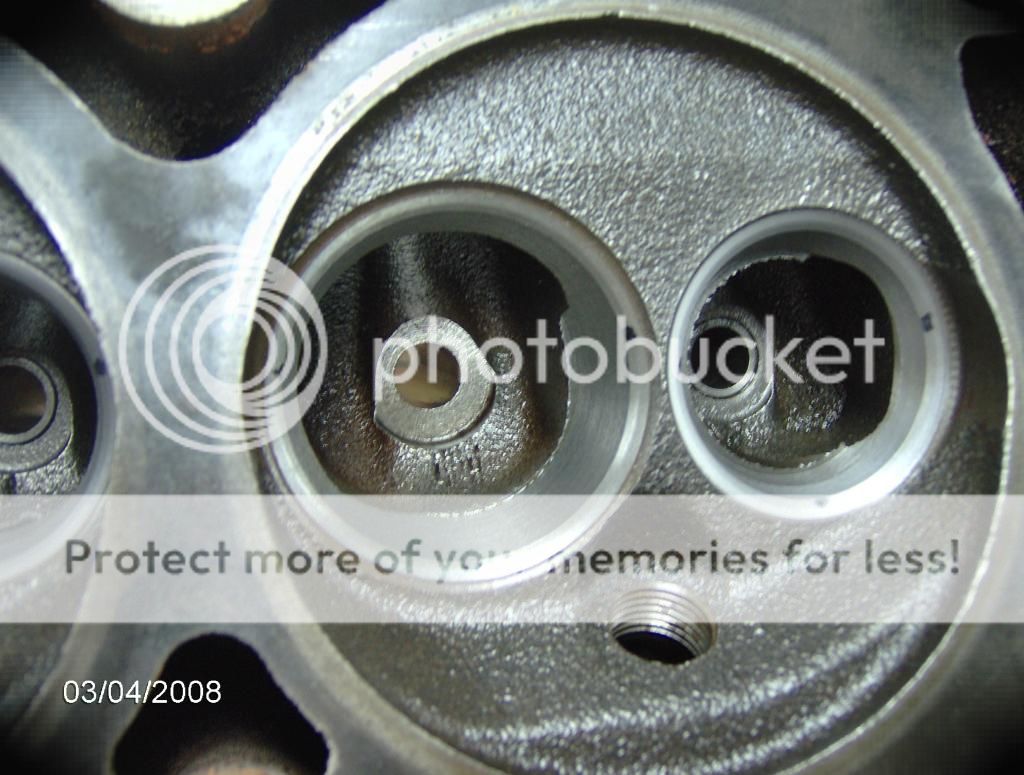

I picked up my head this afternoon and was a little surprised after getting home to see that so much had been removed from the area just below the valve seats. The intake side being most pronounced cause there is quite a bit of material there on the inside ( yellow arrow ) of the head that Im assuming I am going to smooth/blend out into the bowl area?
Is this normal? Maybe they did me a favor and now I have less work to do?
This shop is one of the best around and I am sure they know what they are doing but I still need to ask.

Looks like they did a nice deep 60 degree bowl cut. Now you need to "blend" the bowls, and narrow the guide bosses. You want a pretty smooth surface on the walls, and a nice smooth radius on the short side. A flame tip carbide burr followed by 80 grit tootsie rolls should do the trick. The long style burrs work the best. Put a couple layers of heat shrink tube on the shaft of the burr so you don't nick the valve seats.
Thanks but what does this mean.....and a nice smooth radius on the short side.
Also doing a google search of tootsie roll leads me to think that drum sanders are not the same so what is a tootsie roll? Do you have a part number or reference number?
Continuing to look for answers it looks like there is a short mandrel and a long and a tootsie roll is a sanding drum? Confirmation of this would be nice as well as a source for maybe all that needed in some sort of a kit.
They left the seats un-finished as per my request so I would not have to worry too much about nicking things. I will still however be careful.
