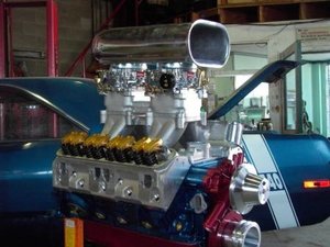

My Combo I was running in my 71 scamp,
360 eng, stock Crank, KB pistons 10,7-1 , eagles H beam rods, Edelbrock heads out of the box, crane roller rockers, Comp solid flat tappet 555 lift, Digital 6 MSD box and dist, Wiend dual tunnel Ram and 2# AFB comp sers carbs 500s . Car #s 3000 lbs me in it, 4 spd with the 833 trans pro shifted by liberty. 4.88 gears, w 28 x 10.5 slicks. Best run 11.50 @ 119 mph 1.60 60 foot, 1/8th 7.45 ,Eng dynode at 407 hp and 401 fpt at rear wheels.
It was a great combo may have ran faster with single Carb set up but I loved my duals. I am now building a R3 59 deg block trying to get into the 9s with the 4 spd car. If not I have a 250 Nos plate on it as well, that oda do it.
PS I had the rev limiter set at 7300, shift light at 6800 rpm, and it never failed I always bounced off the limiter on the 1-2 shift.
