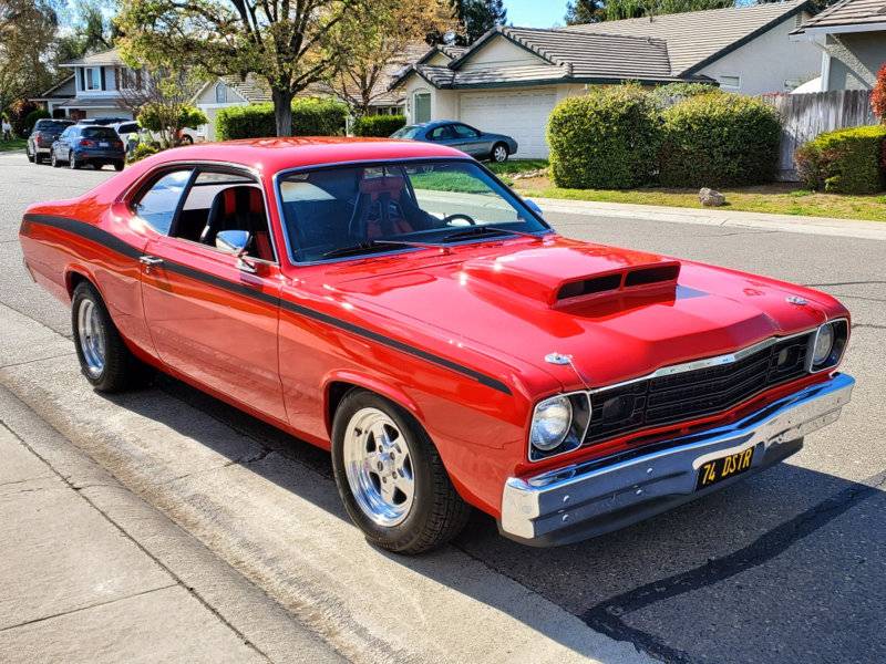

74 Plymouth Duster
Front
Wheel: Centerline Auto Drag
Backspacing: 2 5/8"
Tire size: 195/65/15 (should have used a taller tire)
Suspension Mods: Lots but these would fit the same stock.
Rear
Backspacing: 4 3/4"
Tire Size: 275/60/15
Suspension Mods: Super stock springs, stock tubs.

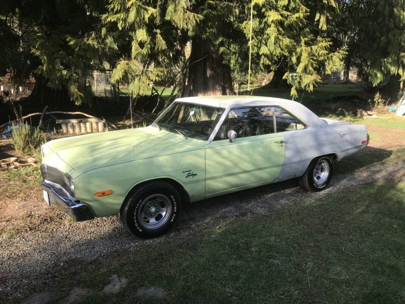

Just got some new meats thanks to you guys 275 60 15x8 4.25 Backspace stock 8.75 Fronts 215 70 14x4.5 im going to slap some 14x6 225 70 on the Fronts so i get more tire filling it up.

That’s a lot of tire for up front. It’ll rub if the front end parts are out of wack/worn, etc...
Looks great though!
The 215/70 is 25.9”, that is really pushing the limit. Turn your wheel out and see how much clearance you have at the front edge of the fender. The 225/70 is 26.5” tall.
FWIW, I had issues with my wife’s Cuda and 26X8-15’s MT’s.

Hey Rob, i was running 225 70 14 before i pulled them off stuck them in the rear of my 64dart on a 14x7 rim, tire looked nice and filled it up in there i rebuilt the frontend 3 years ago 225 70 only rubbed full lock turns on passenger side it rubbed in the inside. But i do like my car front end nice and high no too high so when i catch the ricers over train tracks i dont need to hit the brakes lol

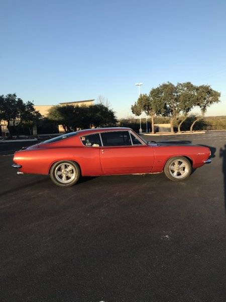

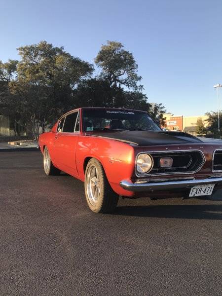

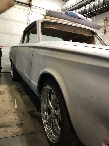

1965 barracuda, rear springs are moved in but stock wheel well but running Yukon axels as they push the offset out 3/8 inch.
Rear tires 275 40r17 and rims are 17 x 9 with 5.95 back space. front rims are 17 x 8 running 225 45r17's with 10"spindles and disc brakes.
I bought these rims from American muscle, yea a mustang place but they were awesome at helping me get the right offset.
