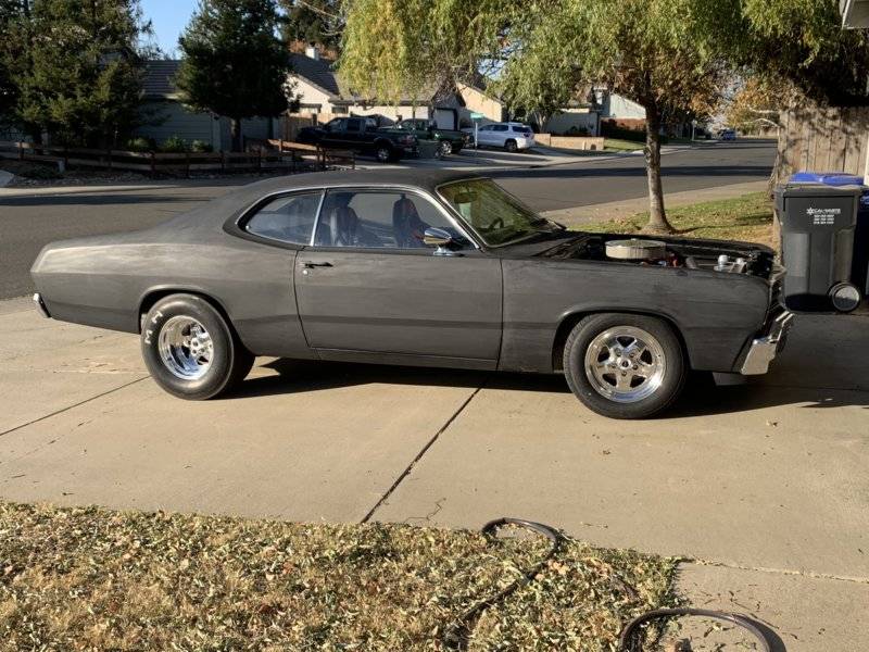

74 Plymouth Duster
Front
Wheel: Centerline Auto Drag
Backspacing: 2 5/8"
Tire size: 195/65/15 (should have used a taller tire)
Suspension Mods: Lots but these would fit the same stock.
Rear
Backspacing: 4 3/4"
Tire Size: 275/60/15
Suspension Mods: Super stock springs, stock tubs.

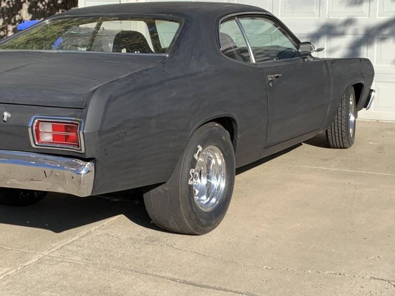

74 Duster
Front
Wheel Brand weld
Size 15x4
Backspacing 1.87
tire size 26x7.50
Suspension mods QA1 arms .93 bars
Rear
Wheel Brand weld
Size 15x15
Backspacing 7.5
tire size 33x21.5
Suspension mod full frame and tub
No thanks. I sold them to a friend. I ask Big Joey from Chitown to close my account. He won’t??? Maybe you can pass this on. Thanks in advance.
Gary
Any suspensions mods to get those in the rear?
A few taps with a hammer on the driver's side inner fender lip at the top. (rear axle must not be centered)
Other mods (that did not create any extra clearance) are 1" lowering springs from P-S-T, and leaf spring hanger flip.
There is about a 1/2 clearance to the leaf springs on the inside, and upper inner fender on the outside.

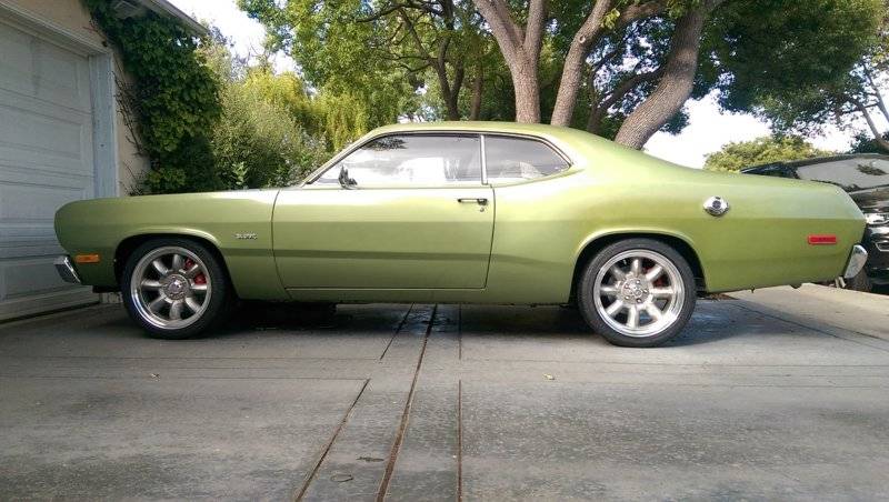

Here's my 72 with 18x9's up front and 18x9.5's out back with 275/35's all the way around. Had to roll and trim the front and rear lips to fit. Next up is fix the paint and add the stripe.
@Red Stripe Very nice!! Do you have more information on the wheels? Brand? Off-set? Where you purchased them? Thanks!!
Thanks! They are ET Wheels LT-III and I got them directly from the company here in CA. The fronts have a 6.25" backspace and the rears are 5.25" backspace. The rears are with a stock 8 3/4 rear but the fronts might be different on others because of the brakes. My Dr. Diff front kit pushes the wheels out about 3/16" but the company can make any custom backspace needed.
ET Wheels by Team III Wheels
Yup, that's how you do it! Nice work! :thumbsup:

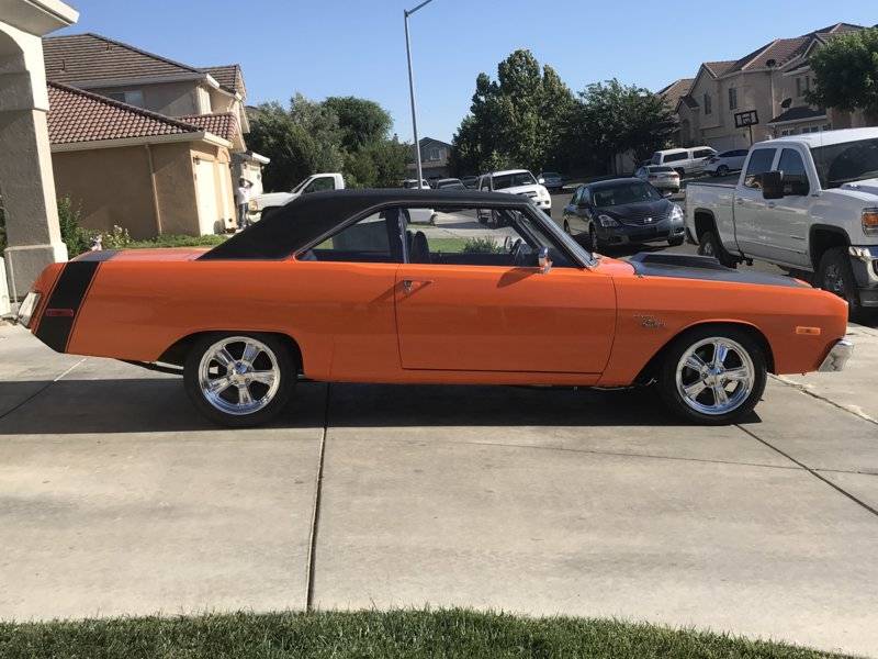

1973 Dodge Dart Swinger- 318 Powersteering Power brakes
I ordered Foose wheels and this is my septup and still working on the car.
Fronts-
225 50 17
(They rub so I ordered 215 45 17 on 10-28-19)
Rears-
255 45 18 (on a right turn, the right rear rubs on quarter panel)

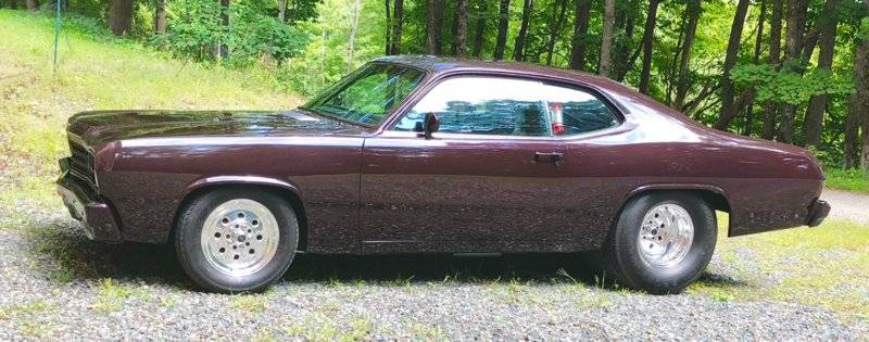

74 Plymouth Duster
Updating my post- went away from the 18’s to go a little more nostalgic. Still have the 18s for now just in case.
Front
Wheel: Vision Nitro
Backspacing: 4”
Tire size: 205/50/15
Suspension Mods: None.
Rear
Wheel: Vision Nitro
Backspacing: 4.5”
Tire Size: 28x12.5 M&H Cheater
Suspension Mods: Narrowed 8-3/4. Super stock springs, bell tech blocks, spring relocation, lots of trimming.
