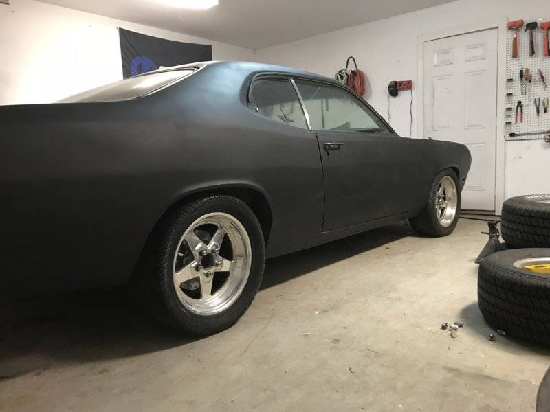

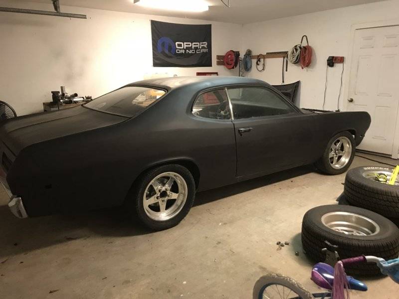

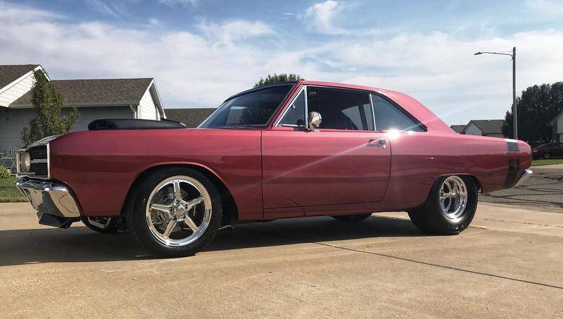

235/60/15 tires rear, 15x7 with 4inch b.s
165/80/15 tires front, 15x4 rim
Vision wheels
Hello love the car. Is that a factory wheel well mini tub? I Just finish my Mini tub.
How tight frame rail to wheel well lip? I am wanting to run the same tire.
Yes just mini tubbed to the frame rails with the factory tubs widened 3”. There’s about 3/4” clearance or so to the frame rail. The real problem comes in when you lower it. You need an after market wheel tub that’s just a touch longer to fit the tall tires.
Awesome thanks. Love the way it fills the wheel tub. Did you move the axle back?

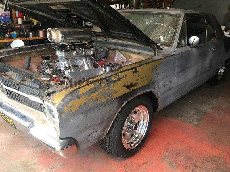

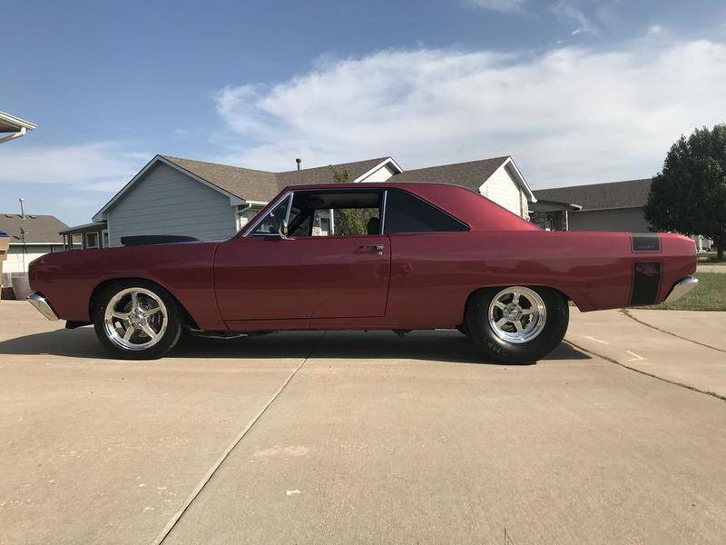

New setup for my Dart.
Billet Specialties Street Lites
Front 17x4 MT Sportsman 26X6.00R17LT
Rear 15x10 MT Radial 315/60/15

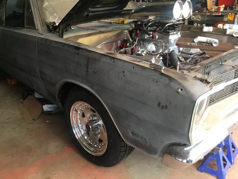

Rears are 225/70/15 on 15X 7 Super Sports 1" adapters with a little surgery on the fender
Fronts are 205/70/14 on 14X6 Super Sports with Right StuffDetailing front discs and no modification ( cant use stick on wheel weights)

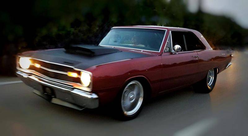

Finally got my “new to me” wheels mounted up today. 17x10 275/40 in the rear, 17x8 255/40 in the front

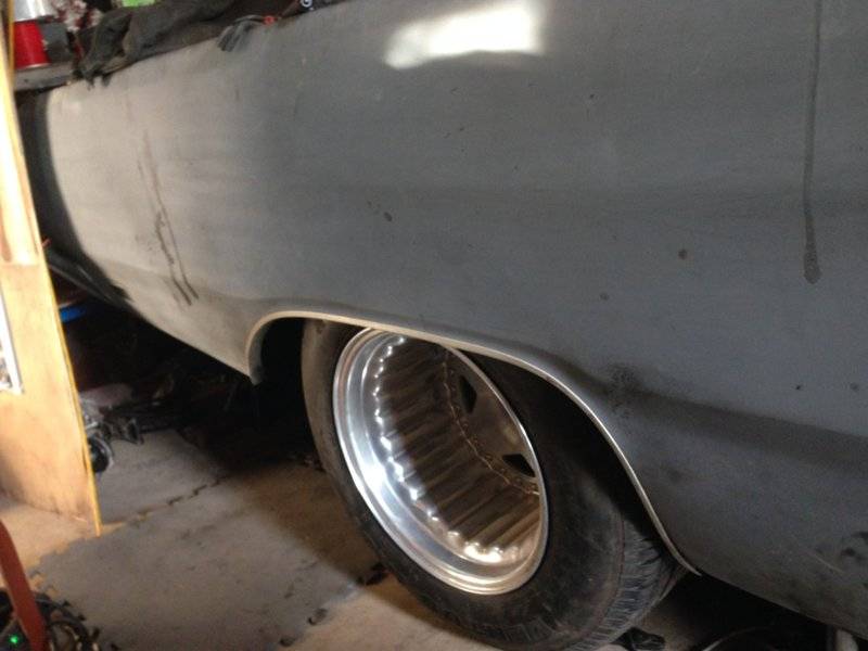

Rear 15x12 with 4” backspacing
Tire 295/50/15
Mini-tub and 4-link
