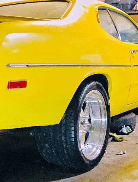

Hi.
I have 8.25 axle. What wheel size you recommend?
I currently have front 15x6 205/50/15 (these scratch fenders)
and rear 15x8 275/60/15 these run fine

Ok, that makes sense for the rears, the 8.25's are narrower than the 8 3/4's by almost a half an inch, and I'm sure the ride height takes care of the rest.
In the front you should be looking for a 15x7" with 4.25" or at least 4" of backspace. Even the 195's on those rims will be all the way out at the fender lips. They might work, but like I said they're pretty much at the limit. They'd sit just as far out as my 275/35/18's on the front of my car, and I had to do a few little things to get mine to clear. The height is super short, if you have to run those rims I'd at least be looking for a 195/65/15, which would be 25" tall.

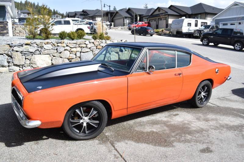

This is my 69 Barracuda, with American Racing Wheels (putting stock rims as we speak)
These are 17 inch wheels...
Front are 45 x 225 x 17
Rear are 40 x 275 x 17
Stock? That’s a shame. Car looks great the way it is!
Thanks but the Hood (it's sacrilegious, have a cowl hood on a Mopar) is getting replaced with a stock hood and Hemi Scoop (68 Hemi Barracuda hood style) and the rims must go dog dish original.
No matter we pushing a nice little small block, 340 six pack, bottle induced, daily driver (summer time only) I just like the " stock look" right down to 15 inch rims.

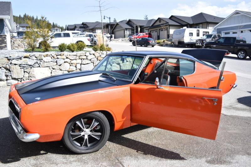

Hey no worries, it's your car, so by all means do whatever you like to it. It should make you happy not me :D, that's why I've got my car right? I'm sure it'll still look great when you've got it back to the way you want it, looks like a pretty clean car.
And on another note, if you're planning on getting rid of those LED headlights for something a little more stock, drop me a message. I've been looking at those as an upgrade for my car for awhile so I'd be happy to buy them if you're gonna change them out.
I hope you know I'm joking, but all kidding aside, I just like the stock look, I also will have a set of aluma star rims for the car for those nights I want it for the track and look as nice as possible with slicks and skinnies.
The car is in good condition as it was a complete overhaul, from floors to trunk, fenders to interior.
I don't think the car has 2,000 miles on it (even the Speedo was redone along with the whole dash) so when you look inside all you see on the dash is about 2,600 something miles on it.
Super clean.
