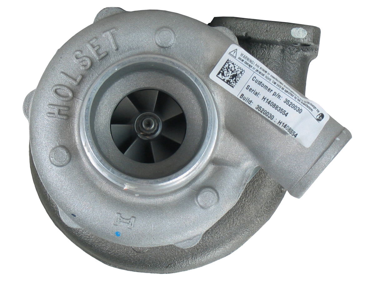

Ok, so one of my local brothers in Christ gave me this today. As I understand it, it should work real good on a slant 6. So Project Cheap & Nasty has a turbo. It's a new reman that's never been run. A bonafide Holset. Looks like I'll have to use an added waste gate. I'll need some help choosing that, as my turbo knowledge is basically nothing. But here it is.
This is also a non waste gated turbo, so I'll have to work around that. I've read you can run them, but I will be needing some advice there.
A non waste gate turbo? I don’t know squat either but I thought you needed a waste gate to blow off over pressure. Is that not how you set your psi? Doesn’t it dump pressure once that set PSI is achieved. Maybe that turbo only maxes out a set PSI for Example like 8PSI max so there is now need for a waste gate. If that’s the case easier plumbing I guess.
There's also blow off valves and such. I don't know a ton about it either, but I know there are some non waste gated systems out there. I guess I'm gonna make one. lol
Wastegates go on the exhaust side and “waste” exhaust energy before the turbo at predetermined a level to keep boost pressure at a specific level.
Blow off valves go on the intake side and open when you slam the throttle shut to “blow off” all the pressure the turbo is making and the engine is now not using because the throttles are closed.
If you look up the part number on that turbo do you find any specs? Like wheel size? Inducer, exducer diameter on compressor and/or turbine? Or what OE application it was from?
Yeah, I know the where. This turbo has no provision for one. It comes up as a "non wastegate" turbo.
OE application was for the 5.9 Cummins. First generation. I didn't find any specifics.
