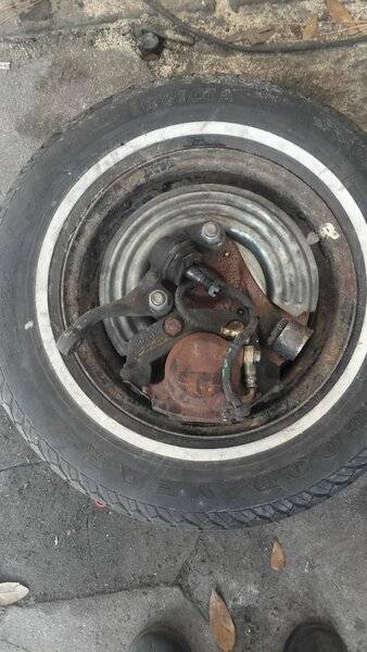

Ive got what I believe is the MB kit . Small bolt pattern . The 14 steel wheels just barely touch the caliper. Havent installed on the car yet because I feel like theyre gonna rub.
