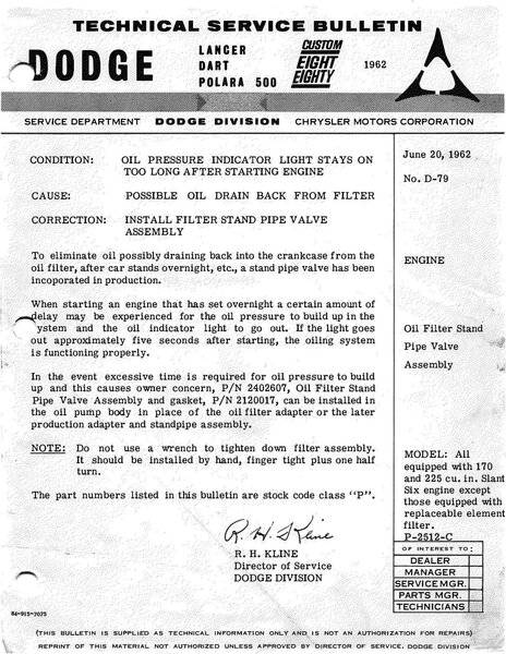

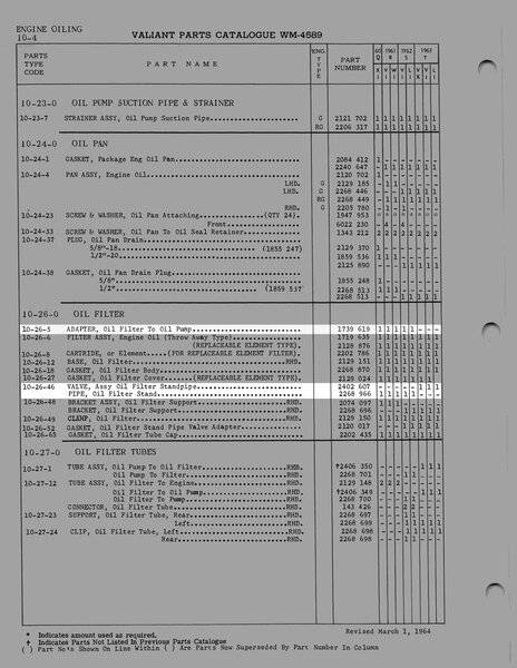

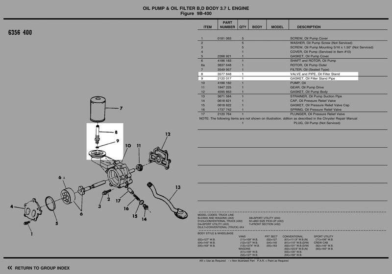

Yet, even Chrysler saw fit to exclude the standpipe on the later models.
No, they didn't; see here.
Here y'go: 1962 TSB referring to the new standpipe with check valve replacing the previous no-valve standpipe and the no-standpipe adapter before that; '60-'63 A-body FPC showing all three parts, and the '86-'87 Dodge Truck FPC (last one to contain Slant-6 engine components) showing the standpipe with check valve.
